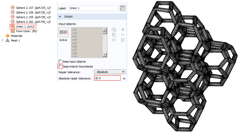

Posted: 7 years ago 2019/02/04 22:54 JST
Sephia,
To mesh geometry, add Union and make sure to clear box "Keep interior boundaries", otherwise meshing would fail.
Sergei
Sephia, To mesh geometry, add Union and make sure to clear box "Keep interior boundaries", otherwise meshing would fail. Regards, Sergei
