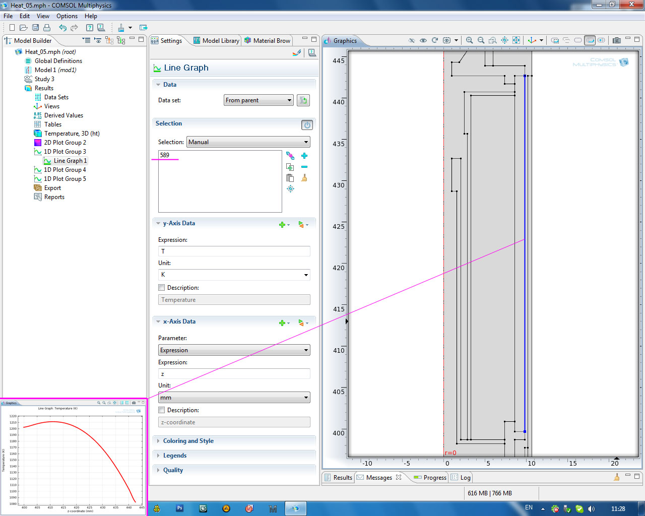

I have already got a temperature field of the model. How I can appropriate / set a variable for temperature distribution on border?

But the thing is that I don’t have to define the function T(z), as it is unknown in the very beginning – it can be acquired only as a result of calculation. I have to assign a variable to the still uncalculated temperature distribution on the element boundary. And then I'd like to use this variable for another function in a section (definition --> function), which depends on it.
Here is an example from another physics field:
We have a diod (2 parallel plates). I need to define the current density as a function of potential distribution on the plate boundary (this potential is initially unknown, as it can be acquired only as a result of calculation, but the dependence of current density on the potential variable on the boundary is given). That is why I need to assign a variable (for example, 'v') to still uncalculated potential distribution on the plate boundary, so I can define a variable to current density j=f(v) in the section “definition->function”.
Do you have any ideas how to put this into life? I guess we should use “probe” here, but I don’t know how and if it’s going to work.

It is clear, that I need to know the value of T or flux/exchange on the boundary, but I have a vague situation over here: I know a flux that is dependent on the T at the boundary of the element... That is why at first I want to assign a variable to a still unknown T on the element boundary, and then to put flux by means of this variable. That is the thing I don't know how to do.. any ideas? :)
