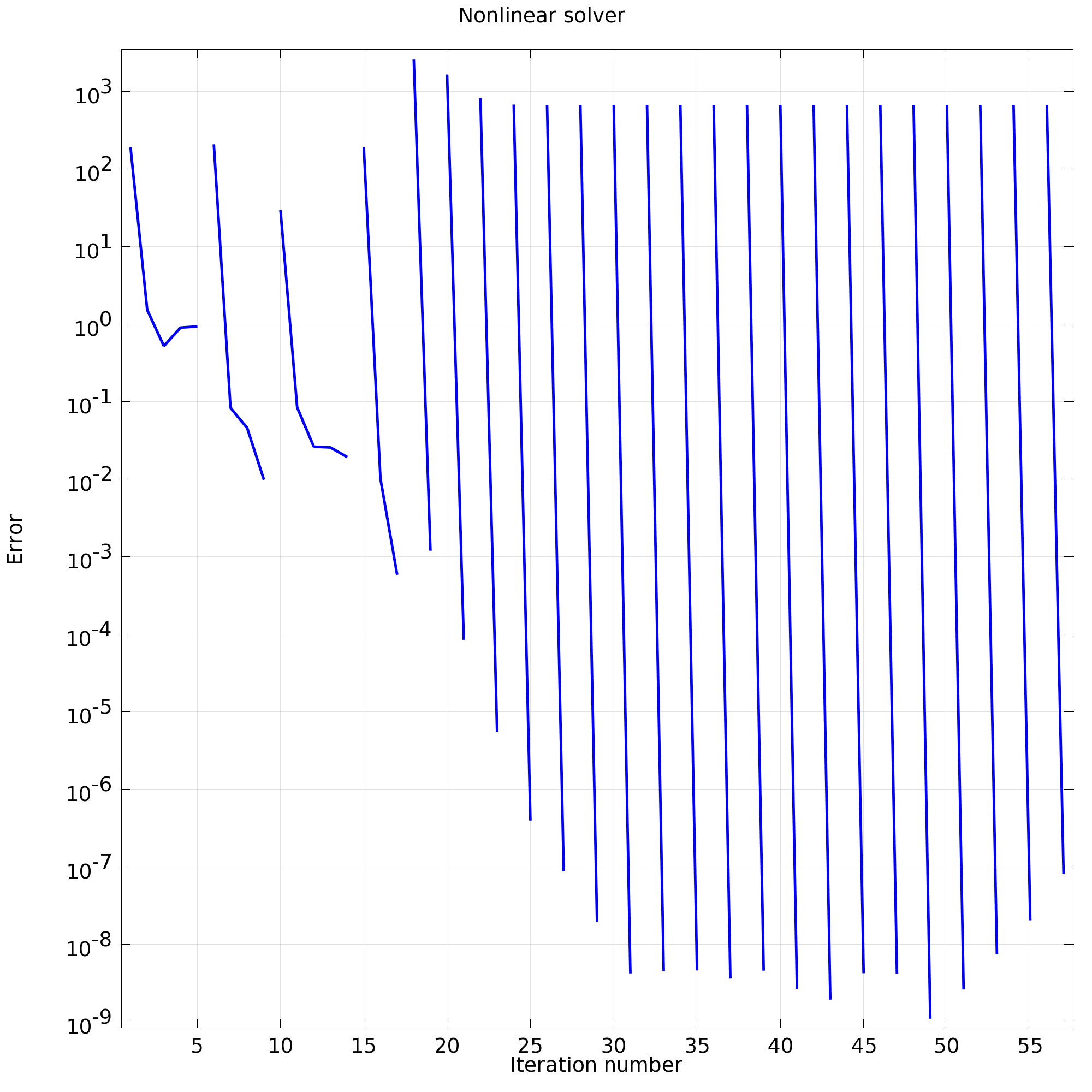

I'm getting this error when running a time dependent simulation of laminar flow in a micro channel. What I want to do is change the input flow on one arm of a y-channel and follow the response in time. Anyway it's this error:
Repeated error test failures. May have reached a singularity.
Time : 0
Now I've seen people with similar problems where it is due to too large a change in the time dependent parameter but I don't see how this is the case here. I am simulating for t=0 with the stationary solver first which is giving the correct result and at t=0 for the time dependent solver the boundary conditions should be exactly the same. I've tried several different time steps and different arrangements for the step function I'm using to change the flow. If it failed as the flow changed I'd think there was a point to the error but this doesn't make sense to me. Anyone have any ideas?

Regarding your convergence plot, it looks perfectly fine.

Posted: 1 decade ago 2015/08/10 21:41 JST
does this do the job for you ? (to understand how to use the parameter t and a boundary load depending on "t"
Its a simple model I load it with the stationary solver and then observe the oscillations with the time series, I defined the model in stationary and then added the time series BEFORE I ran the mode so that COMSOL looked after the coupling. To resolve the oscillations I need to use a shorter time step than the default defined one

Posted: 1 decade ago 2015/08/12 3:14 JST
back in v4.2 days we could not disable certain BCs for different studies, so I used there the trick to set the forces for the BC to "-100*1" for the stationary solver, since when the stationary solver runs, "t" is not defined yet by the time dependent solver, and my parameter "t" is used to set the Force to "-100" via the Boolean expression. Thereafter for the time dependent study, the force disappears from the first step t>0.
In v5.1 you would simply disable the boundary load for the time dependent solver and remove fully the Boolean expression the *(t[1/s]==0) means equal to "1" if t transformed to a number expressed in units of seconds "equal" to "0"
Hi back in v4.2 days we could not disable certain BCs for different studies, so I used there the trick to set the forces for the BC to "-100*1" for the stationary solver, since when the stationary solver runs, "t" is not defined yet by the time dependent solver, and my parameter "t" is used to set the Force to "-100" via the Boolean expression. Thereafter for the time dependent study, the force disappears from the first step t>0. In v5.1 you would simply disable the boundary load for the time dependent solver and remove fully the Boolean expression the *(t[1/s]==0) means equal to "1" if t transformed to a number expressed in units of seconds "equal" to "0" -- Good luck Ivar

Dear Ivar,
Thank you for posting the clarification. Since the original discussion is from 2011 and is regarding COMSOL version 4.0a, we will close this thread for further discussions.
As Ivar correctly notes, it is (as of several versions now) possible to activate and delete boundary conditions in different study steps.
Since the issue of inconsistent boundary conditions for transient fluid flow problems does come up quite often, there is now also this KnowledgeBase Article which will address such questions:
www.comsol.com/support/knowledgebase/1172/
Best Regards,
