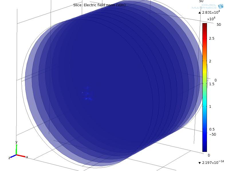

I want to view the electromagnetic field (in particular the norm of E) in the core of 3D fiber model. Through the Boundary Mode Analysis 1, 2 and Frequency Domain of the RF Module, I got the result of some data.
I could not look for the states of progress of the complete Electric Field(or lightwave) like the attached jpg file.
I thought that I properly set up two ports(Numeric). Why did this result come about?
I appreciate your review, I also attach a mph file(ver. 4.0a).

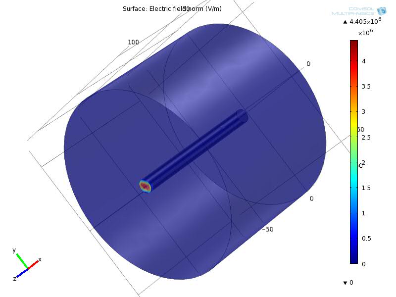

Posted: 1 decade ago 2014/01/22 0:49 JST
HI Akram,
Have you solved this model yet? I am seeing some kind of electric field distribution but it does not propagate through the fiber (it "fades away" immediately after the input port).
If you have a solved model that you are willing to share, or any advice would be much appreciated.
Thanks,
Dennis
HI Akram, Have you solved this model yet? I am seeing some kind of electric field distribution but it does not propagate through the fiber (it "fades away" immediately after the input port). If you have a solved model that you are willing to share, or any advice would be much appreciated. Thanks, Dennis
