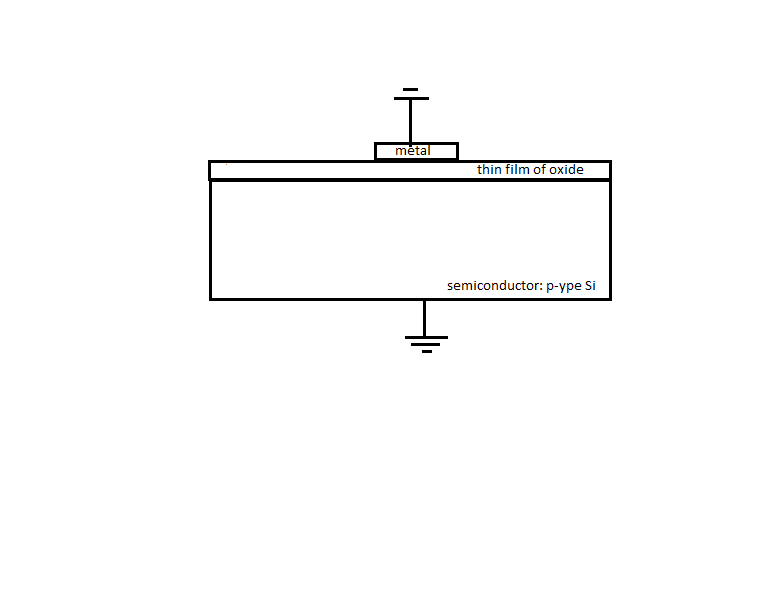

I am intersted to study electric field profile in the thin film oxide before breakdown. I have a device with oxide film sandwiched between metal and semiconductor (schematic attached). I do not want to use the thin film insulator gate approx, instead i wish to explicitly model it coupled with the semiconductor. Is it possible to do it?
I tried coupling electric current physics froom ac/dc module with the semiconductor physics. It says "no coupling feature available for the selected physics interfaces". Can someone please help me out?
