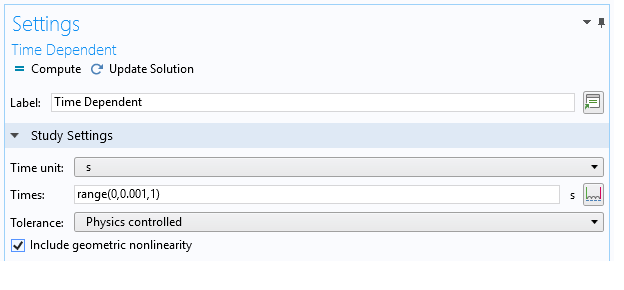

Hello everyone,
I'm trying to run a simulation using the livelink with MATLAB, but I'm having a problem. The thing is, I don't know how to write a code that activates the 'Include geometric nonlinearity' for a transient study in MATLAB. I've read the COMSOL manual, but I found nothing useful. I was wondering if anyone can help me with this.
Best Regards
1 Reply Last Post 2019/02/25 11:15 GMT-5
Posted: 7 years ago 2019/02/25 11:15 GMT-5
The easist way if you do not know the API is to select the check box in the GUI and then do a Save As on .m format. The last line will then look something like
model.study('std1').feature('time').set('geometricNonlinearity', true);
Henrik

Hi, The easist way if you do not know the API is to select the check box in the GUI and then do a *Save As* on .m format. The last line will then look something like model.study('std1').feature('time').set('geometricNonlinearity', true); Regards, Henrik
