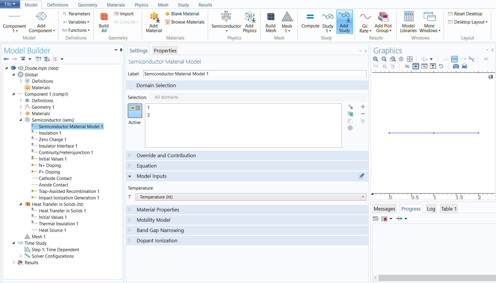

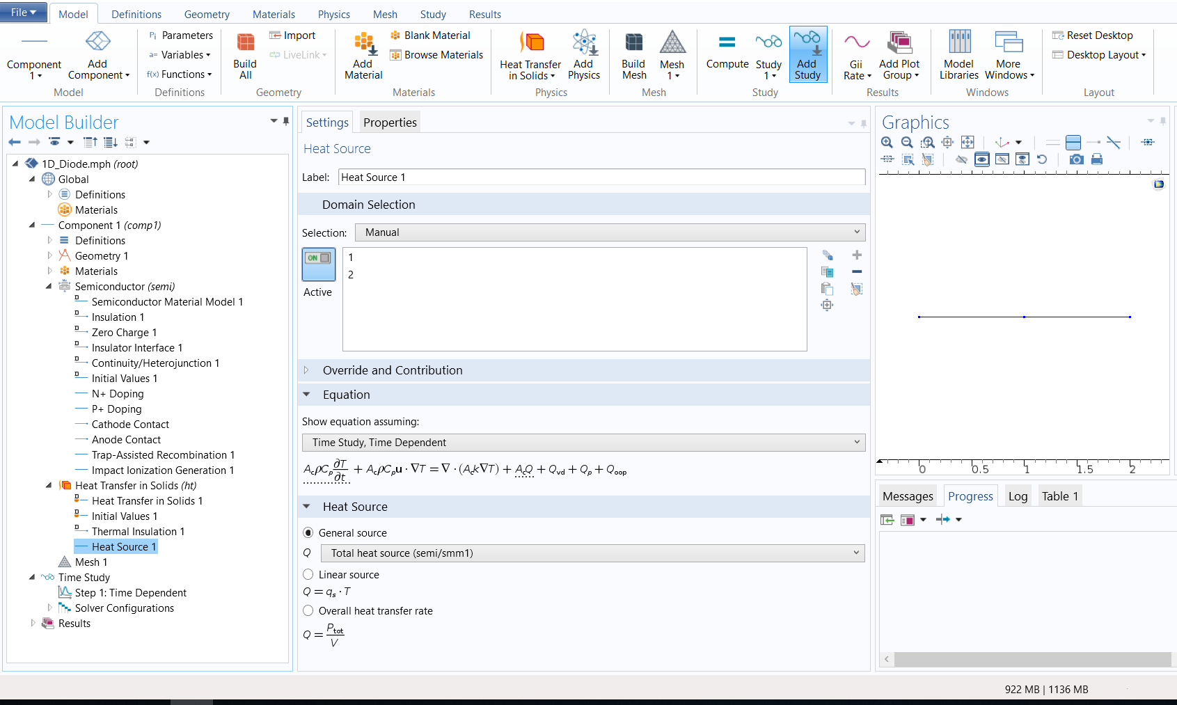

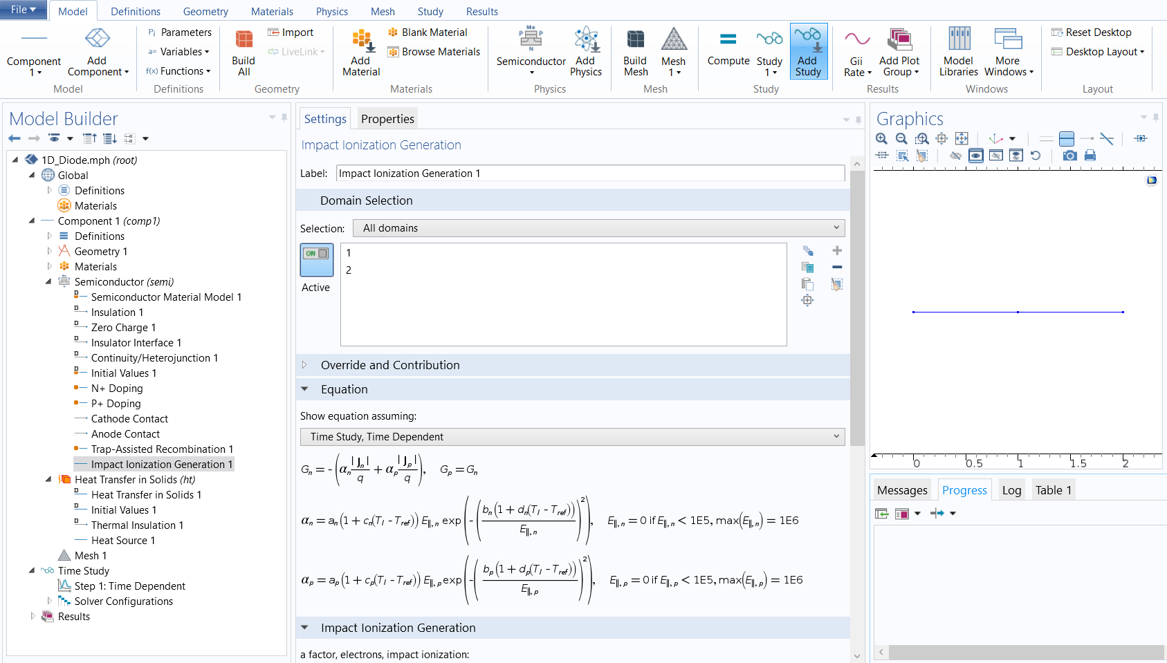

To simulate this I've included Semiconductor and Heat Transfer in Solids modules. I've attached 3 snapshots of all included models and boundries. So here is what I mean by two physics coupling:
Cases 1 - One way couplying semi--->ht
In Semiconductor Material Model, Model Input Temperature is set to constant - 300[K] Heat Source is set to General source: semi/smm1
Time Study Result: Success Simulation completed.
Cases 2 - Two way couplying semi<--->ht
In Semiconductor Material Model, Model Input Temperature is set to - Temperature (ht) Heat Source is set to General source: semi/smm1 (No other change is introduced to the model)
Time Study Result: ERROR - Division by zero. failed to evaluate variable comp1. semi.iig1.alpha p

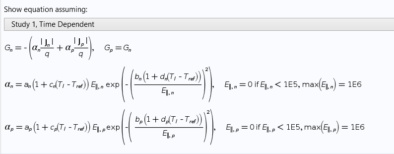

When I try to debugg this error, I trace the cause to Impact Ionization Generation model, where iig1.Epn and iig1.Epp parallel electric field variables are calculated in the following manner: Epn = 0 if Epn<1E5, max(Epn)=1E6 ; Epp = 0 if Epp<1E5, max(Epp)=1E6
So my question would be, why am I seeing this error when I try a two-way coupling? Is there a initial condition that should be altered in Case 2 ? Alternatively, is there a way to alter the value of iig1.Epn and iig1.Epp parallel electric field variables? Any wisdom on this would be much appreaciated. Thanks!

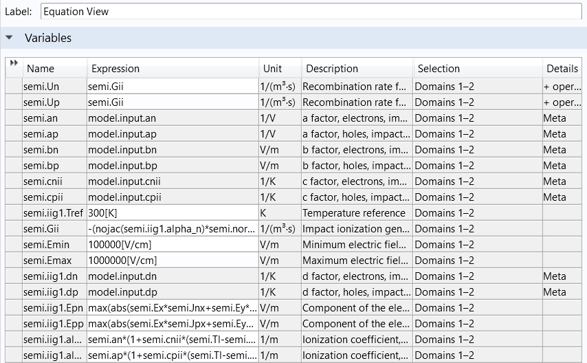

So, I'd speculate that in equation for either "semi.iig1.Epn" & "semi.iig1.Epp" the syntax is as follow:
Epx = max(abs(total_sum)/valX,0)
So, for Epx to be equal to zero 0, the only way I see is valX to be a negative number. E.g. "semi.normJn" and "semi.normJp" must be negative, which to me does not make sense. I've tried putting abs() around "semi.normJn" and "semi.normJp" but the error remains. Also, in equation view table in the IIG model, there is an a threshold value for E=1E5, which I couldn't find where it is specified or why (picture attached*). If anyone has any suggestions regarding the nature of this error or information about where and why is E threshold value defind, it would be much appreciated!
Regards, John
