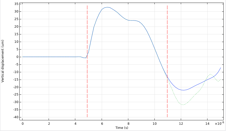

Here is an example where two extra Point Graph nodes are used for drawing the vertical lines:
https://www.comsol.com/model/wave-propagation-in-rock-under-blast-loads-12811
Henrik
