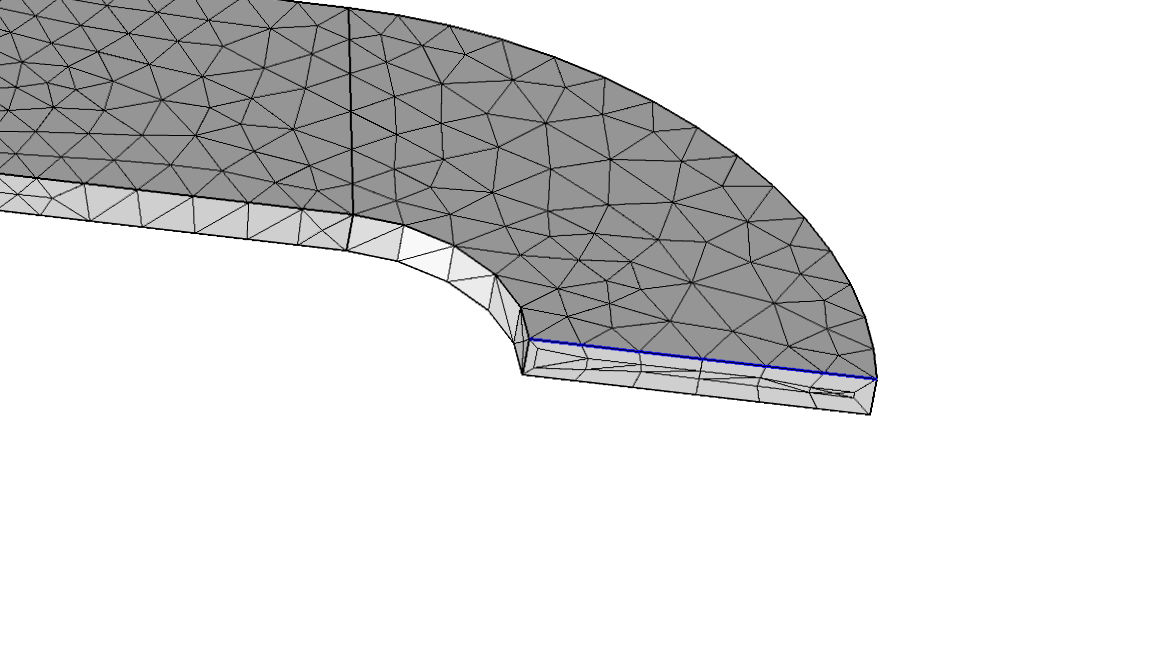

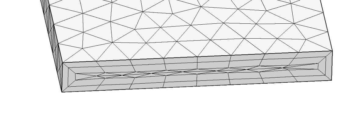

so I tried a different mesh and also a Swept mesh... (see picture) but I sitll could not find a solution. Any other ideas? When I try to solve this geometry only with a stationary step and with the standard solver, comsol does find a solution. But with the same solver condition (and same mesh) with the transport of diluted species, it does not find one. I really do not know what to change to get it to work.... any suggestions? Thanks a lot!
Hi, so I tried a different mesh and also a Swept mesh... (see picture) but I sitll could not find a solution. Any other ideas? When I try to solve this geometry only with a stationary step and with the standard solver, comsol does find a solution. But with the same solver condition (and same mesh) with the transport of diluted species, it does not find one. I really do not know what to change to get it to work.... any suggestions? Thanks a lot!
