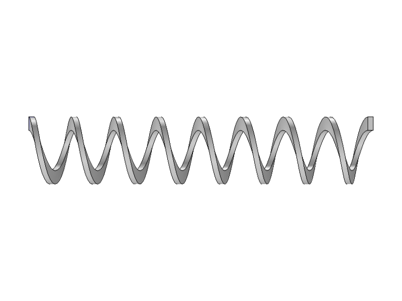

helix with rectangular cross section.
hello
I need to know how to make a helical ribbon with rectangular cross-section.

Hi Jason:
Is this what you want? I made it by sweep a rectangle with a helix. If yes, I can upload the model.
Hi Jason: Is this what you want? I made it by sweep a rectangle with a helix. If yes, I can upload the model.
Posted: 1 decade ago 2011/10/27 23:27 GMT-4
yes, is exactly that I need.

Sorry for that. Below is how I made it.
First is create a rectangular in a work plane.
Second, make a parametric curve to represent the helix curve, like (cos(4*s),sin(4*s),s).
Last, sweep the rectangular with parametric curve. Pay attention to uncheck the "twist compensation".
Sorry for that. Below is how I made it. First is create a rectangular in a work plane. Second, make a parametric curve to represent the helix curve, like (cos(4*s),sin(4*s),s). Last, sweep the rectangular with parametric curve. Pay attention to uncheck the "twist compensation".

Sorry to bother you with this; the posting is quite old but it is exactly what I need. However, I don't seem to get exactly the same in 5.2a as the image 123.png posted here. Would you mind posting a more detailed explanation on how to sweep the rectangle to get the helix and with which parameters you did it? I am a complete newbie and still have problems with basic things; sorry.
