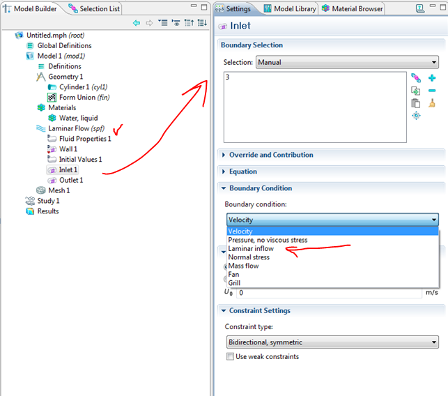

have you checked (see capture image below) laminar inflow.
