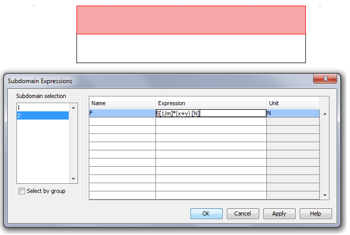

Posted: 1 decade ago 2011/11/12 23:04 JST
I can see no error in the expression..have a look at the attached pic file...
cheers
I can see no error in the expression..have a look at the attached pic file... cheers
Posted: 1 decade ago 2011/11/13 13:58 JST
Thanks! It worked...just 2 quick questions:
1. in the in-compressible navier stokes module, in the subdomain settings, there is also a section for porous flow, where u can introduce brinkmann number etc....what does that do? Does it make my given fluid into a porous medium with those assigned properties?
2. If I want to introduce a time-varying volume force, and I don't use moving mesh, is there any way to see the output at a particular time, say at t=5sec?
Thanks a lot for your help, and sorry for the bother :-)

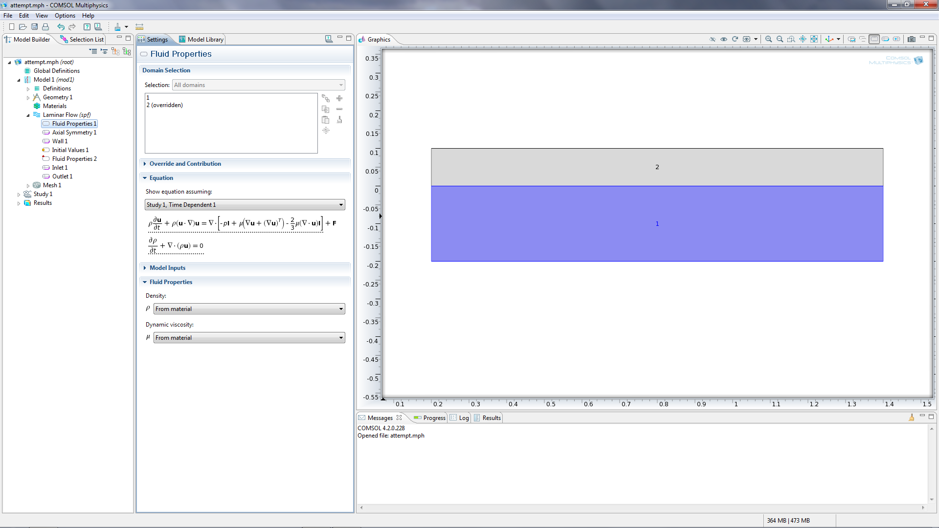

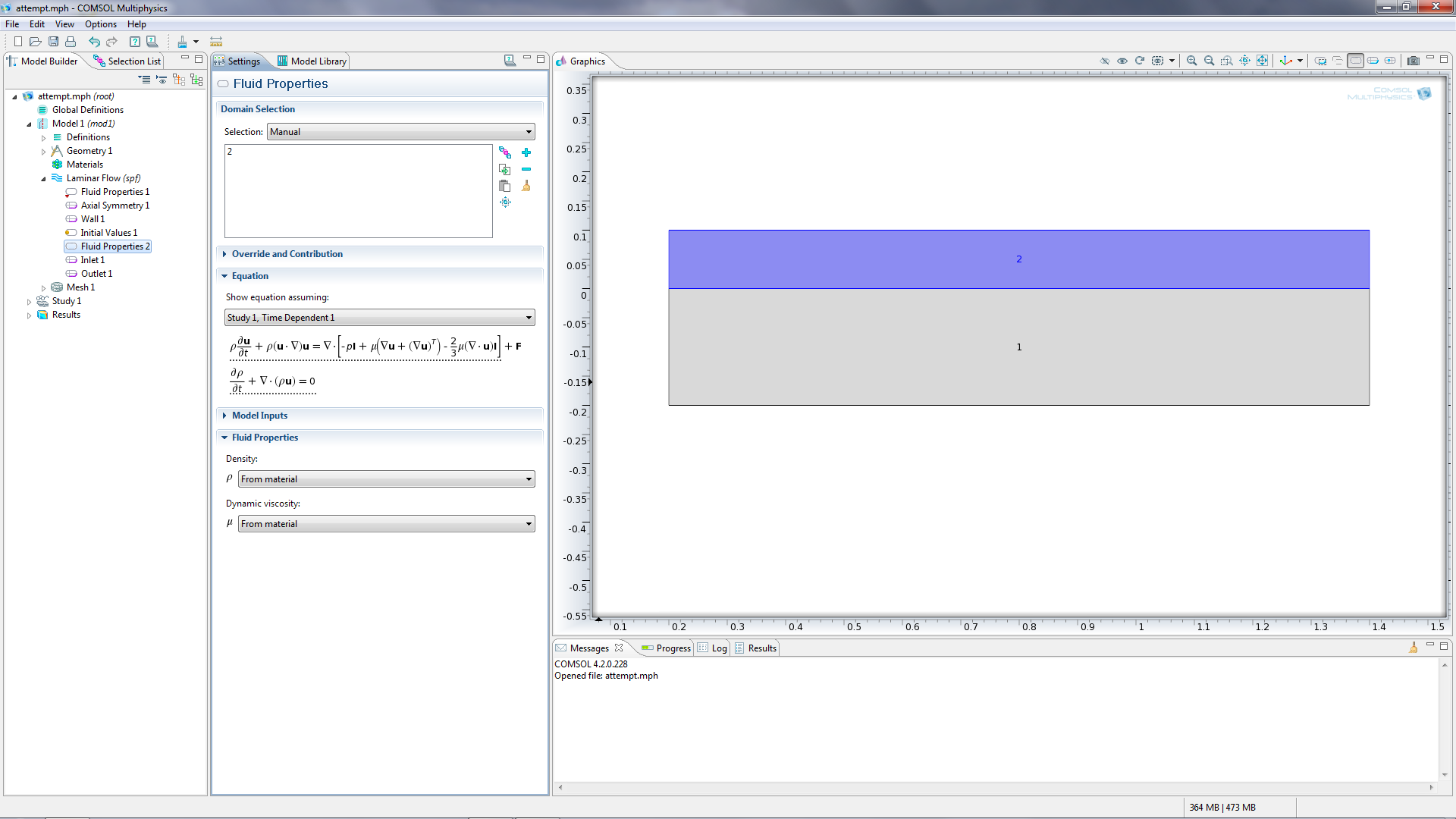

Posted: 1 decade ago 2011/12/02 14:41 JST
Due to certain problems, I've had to shift to COMSOL 4.0 version...in this, a unique problem that I'm facing is that when I select boundary conditions, whatever I apply to any one boundary gets applied to all of the boundaries...so basically I'm not being able to specify separate boundary conditions for each boundary...please help!
Hi, Due to certain problems, I've had to shift to COMSOL 4.0 version...in this, a unique problem that I'm facing is that when I select boundary conditions, whatever I apply to any one boundary gets applied to all of the boundaries...so basically I'm not being able to specify separate boundary conditions for each boundary...please help!
Posted: 1 decade ago 2011/12/02 16:03 JST
attach your model file..it should not be possible. Are you using Comsol 4.0 or 4.2a? the latest one is 4.2a. I recommend not to use 4.0, it had lot of problems, however i didn't face such boundary condition problem in 4.0.
Posted: 1 decade ago 2011/12/02 22:04 JST
There's a place in the settings window, where it says 'All domains'...so whatever settings I apply to any one domain applies to all of them...all the boundaries etc etc...somehow I just can't change that....there's no option to make it from 'All Domains' to specified domains...
I really haven't done very much..I'm just trying to assign different boundary conditions to each of these boundaries..
Btw, what kind of problems did 4.0 have...I'm using 4.0,not 4.2....will they seriously disturb my work?
There's a place in the settings window, where it says 'All domains'...so whatever settings I apply to any one domain applies to all of them...all the boundaries etc etc...somehow I just can't change that....there's no option to make it from 'All Domains' to specified domains... I really haven't done very much..I'm just trying to assign different boundary conditions to each of these boundaries.. Btw, what kind of problems did 4.0 have...I'm using 4.0,not 4.2....will they seriously disturb my work?
Posted: 1 decade ago 2011/12/03 0:31 JST
you need to add extra boundary conditions; by default Comsol starts with one option for each "fluid properties 1", " Wall 1", "Initial values 1", if axial symmetry then "Axial symmetry 1". Now to add inlet, outlet or if you want to define second sub-domain with different fluid properties then right click on "Lamina Flow (spf)" and add whatever you want. e.g. after adding extra "Fluid properties 2" you can go the geometry window, select and right click whichever domain you want to add under Fluid properties 2; similar procedure apply for boundary selection.
I don't have 4.0 on my workstation and you can not open any file saved using 4.2a in 4.0, so I am not attaching the modified file..though I have attached couple of snaps for your reference.
you need to add extra boundary conditions; by default Comsol starts with one option for each "fluid properties 1", " Wall 1", "Initial values 1", if axial symmetry then "Axial symmetry 1". Now to add inlet, outlet or if you want to define second sub-domain with different fluid properties then right click on "Lamina Flow (spf)" and add whatever you want. e.g. after adding extra "Fluid properties 2" you can go the geometry window, select and right click whichever domain you want to add under Fluid properties 2; similar procedure apply for boundary selection. I don't have 4.0 on my workstation and you can not open any file saved using 4.2a in 4.0, so I am not attaching the modified file..though I have attached couple of snaps for your reference.
