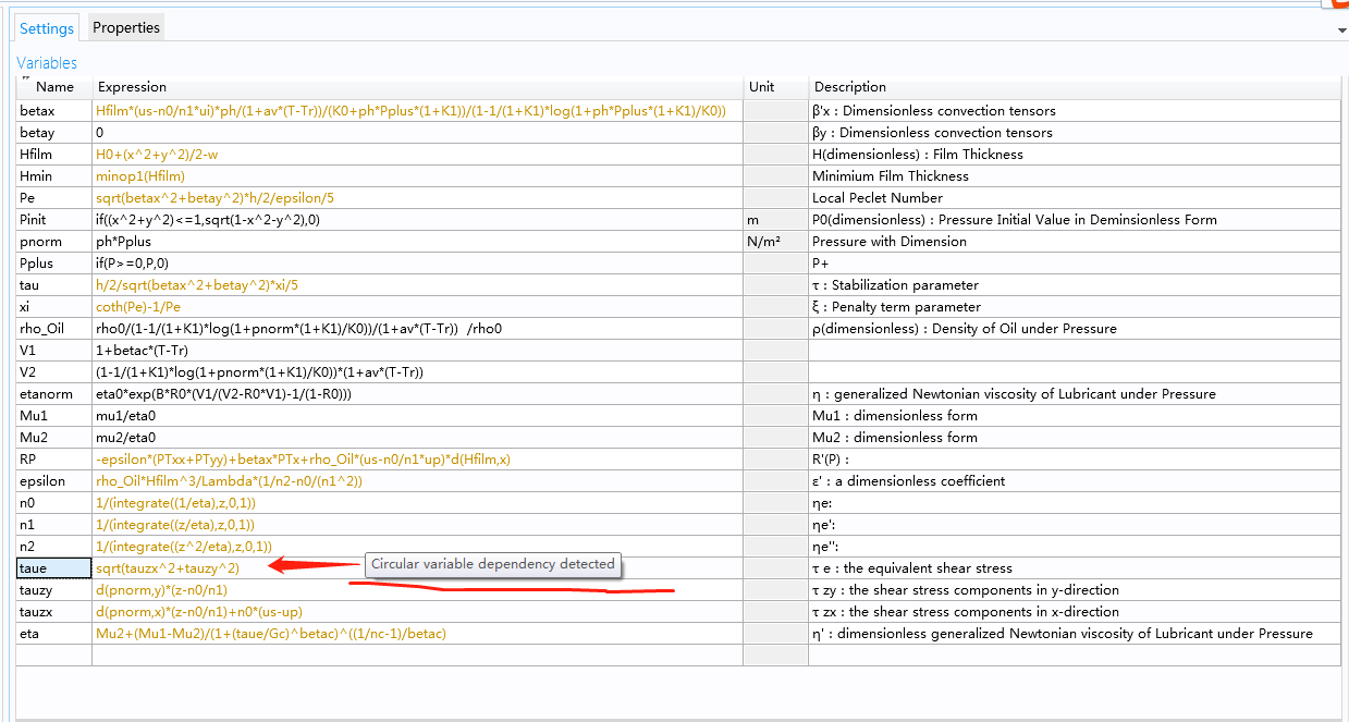

Hello!I meet a problem,when i click the study,it shows a error:Loop variable correlation was detected.If you have met this problem before,could you teach me how to solve it,please................. the error it shows like this: Loop variable correlation was detected. - Variable: comp1.taue - - Geometry: geom1 - - Border: 6

Hi,firstly,I am sorry for my unclear statement and thanks your advice. So,I show you a screenshot: τe(taue) is detected as a circle variable. I think there is no mistake in its definition. And I've been reading a paper that says need to give τe an initial value.So do you know that how I can add an initial value to it? Please.......

COMSOL is warning you that you have a circular dependency.
And indeed, tau_e depends on n0 and n1 (through tauzx and tauzy), which in turn depend on eta, itself dependent on tau_e.
There might be other circularities but this one is the most obvious.
If your definitions of tau_e, etc. are correct, this means that you must input this as an equation to solve for, but you can't do it as a series of variables.
COMSOL is warning you that you have a circular dependency. And indeed, tau_e depends on n0 and n1 (through tauzx and tauzy), which in turn depend on eta, itself dependent on tau_e. There might be other circularities but this one is the most obvious. If your definitions of tau_e, etc. are correct, this means that you must input this as an equation to solve for, but you can't do it as a series of variables.
