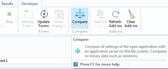

Are you aware that you can compare the mph files directly? See the attached screenshot.
If you want a shortcut for saving as java, you can add a very short model method for that operation. It would only need a single instruction like
model.save("C:\tmp\myfile.java", "java");
Henrik

Hi Alexis, Are you aware that you can compare the mph files directly? See the attached screenshot. If you want a shortcut for saving as java, you can add a very short model method for that operation. It would only need a single instruction like model.save("C:\\tmp\\myfile.java", "java"); Regards, Henrik

Thanks for your reply!
Sadly I do not have access to model methods as a Linux user, which is frustrating because that would have matched my need exactly.
I never tried the direct comparison, I will give it a go!
Thanks for your reply! Sadly I do not have access to model methods as a Linux user, which is frustrating because that would have matched my need exactly. I never tried the direct comparison, I will give it a go!
