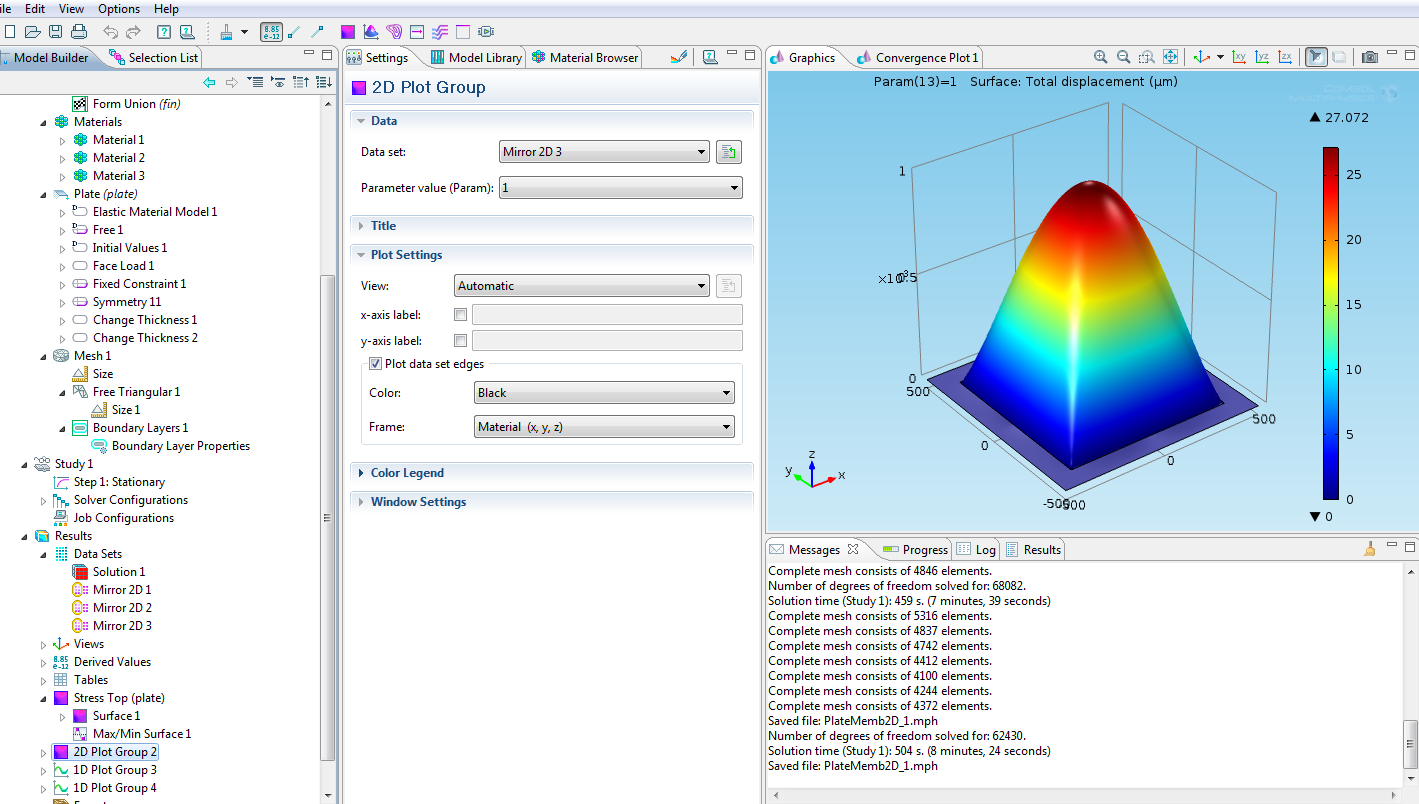

For a 1/8 symmetric model in 2D I have no problems to mirror 3x and get out a full 3D plot (v4.2a)
but this is not "cyclic" or ?
Hi For a 1/8 symmetric model in 2D I have no problems to mirror 3x and get out a full 3D plot (v4.2a) but this is not "cyclic" or ? -- Good luck Ivar

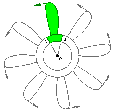

Here is a figure (from the internet) that shows what I think Chong means by cyclic symmetry. I find this type of symmetry more typically called rotational symmetry. There is a different analysis procedure, mainly in solid mechanics, called cyclic symmetry for solving a rotationally symmetric structure under general (non-rotationally symmetric) loads.

Here is a figure (from the internet) that shows what I think Chong means by cyclic symmetry. I find this type of symmetry more typically called rotational symmetry. There is a different analysis procedure, mainly in solid mechanics, called cyclic symmetry for solving a rotationally symmetric structure under general (non-rotationally symmetric) loads. Nagi Elabbasi Veryst Engineering
