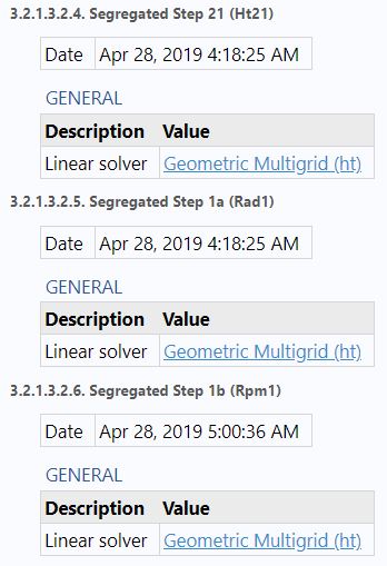

In COMSOL Multiphysics 5.4, I had run two simulations using the Time-dependent Study. In them, the Iterative solver was used. According to the Complete Reports that were written from these simulations, there were three additional Segregated Study steps done in Simulation #2 that were not done in Simulation #1. These additional steps, as they are described in the Complete Report that was written from Simulation #2, is attached to this post as a JPG image ("AdditionalSegregatedStudySteps.JPG").
May you explain how the execution of these three additional Segregated Study steps in the Time-dependent Study affects the results in terms of their accuracy?

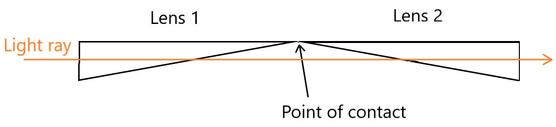

In Simulation #2, there were two lenses, where the second one was placed immediately after the first one, i.e., with no gap in between them. That means that they were in physical contact with each other, although I do not know if this physical contact was perfect. The second lens was made by using the "Array" subnode in the Geometry node. The value I inputted into the "Displacement" setting in the "Array" subnode was the length of the first lens, which had 14 decimal places in 15 significant figures (1.26582278481013 mm). The use of the "Array" subnode means that these lenses are identical to each other.
To give you an idea of what the physical contact between the lenses looks like, please see the JPG image attached to this post named "TrianglesInContact.JPG". Then extrude these triangles into the screen/page such that there are now two triangular prisms in contact with each other at one of their edges. Along the direction of the extrusion, there are 13 linearly-spaced rays that travel into the prisms in the direction shown in that JPG image.
In the Geometry of the two lenses, there are 114 such edges of physical contact.

Please also note that the monochromatic light had a photon energy of 23 keV (2 significant figures), i.e., an energy in the x-ray energy range. Therefore, the refraction done by the lenses is very small to the extent that it is reasonable to approximate the path of the light ray shown in "TrianglesInContact.JPG" as a straight line.
