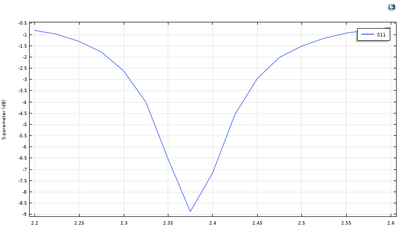

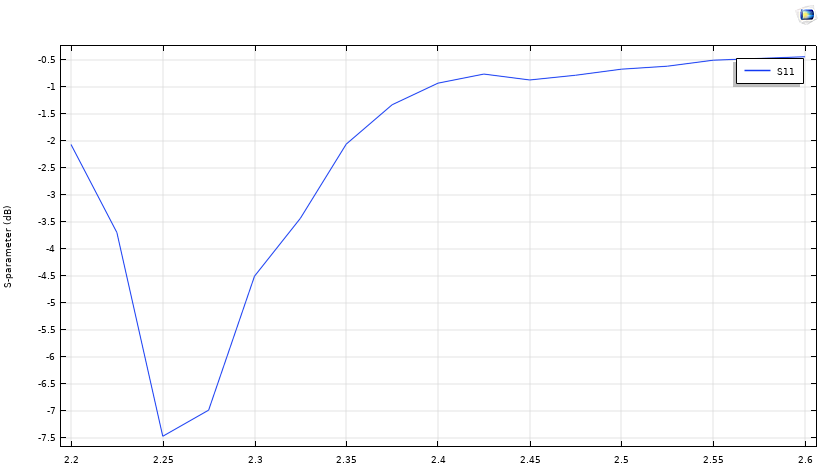

I have achieved two very different S11 parameter plots for the same patch antenna simulation at "extremelly coars" and "normal" element sizes of mesh. I attached these two results as image files to this question. "normal" one is more similar to the measurement results. But how can I be sure which element size is enough for me. Because, the finer element sizes are very heavy for my computer.

Well, you can be moderately more confident that the normal mesh is giving better results than the coarser mesh. You might want to also try models with different settings of discretization (linear, quadratic, etc.), or use a slow but stable iterative solver (if you aren't already), like GMRES with the SOR vector preconditioner, along with a relatively fine mesh, and then even consider a higher level of discretization (if you have enough memory), to achieve high accuracy. Regardless, use your finest mesh settings on the patch and its local substrate, but leave the surrounding space/volume at coarser mesh settings, to keep the computational size under control. Finally, also bear in mind that if you are modeling just one simple patch antenna, but are already running out of memory, then you are either using your memory rather wastefully in your model or have a very limited-capability computer. If the latter, you may want to think about upgrading your computer hardware.
