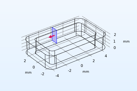

I want to simulate the result as changing inductace of coil in an active eddy current sensor with different material target. The Multi-turn coil numeric fuction is selected to simulate regtangular coil geometry. I use two steps in simulaiton; step1 Coil Geometry Analysis and step2 Frequency Domain. However, I cannot find the coil inductance parameter in results. There are only coil current and coil resistance DC.

in a frequency domain setup with a numeric coil in mf-physics I see all the coil parameters in the results section.

Thank you very much. I found it.
