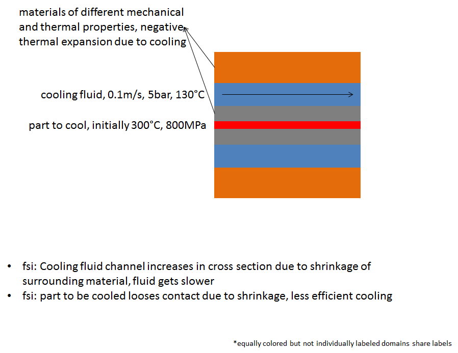

I have a project where I simulate the cooling of a polymer part in a steel mold that is cooled by water (injection molding). The mold is initially at the same temperature as the cooling fluid and the polymer part is well above that (about 200K).
I am interested in the dynamics of the cooling process as well as the occuring thermal stresses due to the temperature gradients within the mold and the polymer part. Furthermore, I like to check on the influence of thermal expansion on the flow of the cooling liquid (expansion or contraction of the flow channel due to expansion/contraction of the surrounding material) and the heat transfer of the polymer part (loss of wall contact due to shrinkage).
My question is wether or not I can couple these three physics and obviously in what way I can do it, if it is possible. If it is possible, maybe there is a tutorial that I didn't find yet. Up to now I only found tutorials for thermal stress and heat transfer and conjugate heat transfer, respectively.
Any help or recommendation on where to start is greatly appreciated.
Best regards, André
PS: Also I attached a 2D primitive sketch of the geometry with basic process parameters. The original 3D geometry is rather complex with small geometric features so I thought I start simple to familiarize myself with the necesseary model set up.

Changes in flow duct geometry due to thermal expansion is usually small, say an area change of 1% for a temperature difference of 200 K. The change in viscosity of the fluid will be much larger than that, and be the dominant effect in most cases. There could however be cases where large overall structural deformations caused by thermal expansion affect the geometry of a thin channel to significant degree.
Whether the deformation of the structure is caused by thermal or other effects is not important to the problem. When using FSI you select in which domains to use moving mesh, and all such domains have their shapes controlled by the structural deformations in the adjacent domains.
FSI, heat transfer, and thermal expansion should work seamlessly together. There are several possible entry points because of the multiphysics involved. In either case, you need to add some of the multiphysics couplings manually.
Maybe the most natural starting point is to start by adding Fluid-Structure Interaction. Then continue by adding the Heat Transfer in Solids and Heat Transfer in Fluids physics interfaces to the appropriate domain. Finally, the multiphysics couplings Nonisothermal Flow, Thermal Expansion, and Temperature Coupling must then added manually to the model.
There are many possible combinations of bidirectional and unidirectional couplings in a problem like this. This will strongly affect the optimal solver strategy.

By the way, there are other complications in your model too: The possible loss of wall contact between the plastic and the mold. As long as the plastic can be modeled using Solid Mechanics, this is feasible (it is 'just' a contact problem), but if the plastic is initially a fluid which through a phase change is converted into a solid, then the problem is much more difficult.

first of all I tried to implement your and Jims suggestions. However, I ran into some problems regarding the contact between the mold and the plastic part.
Secondly, thanks for your efforts in providing an example and your additional information.
Regarding your comment: The plastic initially is a fluid. However, since the plastic is solid close to the wall due to the low temperature of the mold and since the properties do not vary to much between solid and liquid state, I assumed the entire plastic part to be solid as a starting point.
As you pointed out, I do have a contact problem. This means, that I need to form the geometry in assembly mode. (This is what I understand from the manual.) By choosing assembly mode, Comsol automatically creates contact pairs, which also include those for the contact between the fluid domain and the solid mold. In this configuration neither FSI nor FSI (Pair) multiphysics will recognize the respective boundaries as valid and indicate that the boundary condition is not applicable.
Furthermore, I included gravity as a body force. Otherwise due to contact loss there wouldn't be any heat transfer. However, the plastic part moves right through the mold when I try it. I guess there is something wrong with my contact boundary condition. For implementation of the contact boundary condition I followed a video presentation (indentation test, halfsphere steel and rubber) from the Comsol website.
And finally, actually there is no heat transfer between the plastic part and the mold. I added a pair thermal contact node to the ht-interface and also added the temperature coupling and thermal expansion to the Multiphysics-Node. However, there is absolutely no change in temperature. Du I need to imlement the boundary condition differently?
