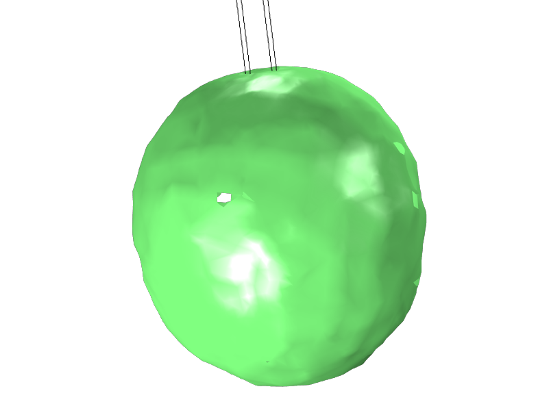

I don't really understand what you mean by "isosurfaces that are actually in the model", the isosurfaces that we are looking for are in the results, extracted with an isosurface plot. We would need an equivalent to: Right click on the isosurface plot > Add plot to export > in the export node, select VTK as export format.
The broken mesh aspect is actually secondary issue for us, since we manipulate the mesh in post-processing anyways. But we were a bit surprised that some triangles are missing from the surface. Such as shown in broken_mesh.png
You can find attached a simple model illustrating that.

In 5.4 and earlier COMSOL versions, isosurfaces can have small holes if the isosurface curves sharply (compared to the local element size). This will be fixed in the next major release, tentatively schedules for this fall.
