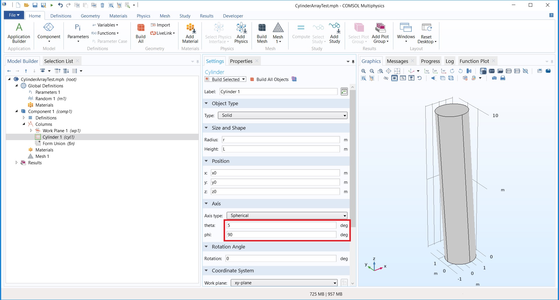

Hi. I plan to design a model geometry composed of an array of simple columns (or simply vector lines, whichever is easier) where each column has a randomized tilt.
Questions:
  1. Is there a log/immediate window where I can test operators? The description in the help for the random (normal and uniform) operators are very limited with no description of what the variables do and I initially had some trouble getting them to work properly for building geometry.
  2. What is the best documentation/tutorial/sample model on how to build custom functions? I will want theta to be randomized from a normal distribution around 2, with the additional condition that it can never be less than two.
Mvh Milum

Hello Mikael,
Here is a blog that should help you get going with creating your randomized geometry.
Jeff Hiller
Hello Mikael, Here is a [blog](https://www.comsol.com/blogs/how-to-create-a-randomized-geometry-using-model-methods/) that should help you get going with creating your randomized geometry. Best regards, Jeff
Posted: 6 years ago 2019/06/18 2:48 JST
Updated: 6 years ago 2019/06/18 2:48 JST
Thank you. I found the example with the cheese just after I posted, and I think I can progress using the record methods approach.
I updated the post to the more relevant remaining questions, in particular how I can test functions and operators in something akin to an immediate window?
Maybe its simpler to just write the functions in matlab and link them.
Thank you. I found the example with the cheese just after I posted, and I think I can progress using the record methods approach. I updated the post to the more relevant remaining questions, in particular how I can test functions and operators in something akin to an immediate window? Maybe its simpler to just write the functions in matlab and link them.
