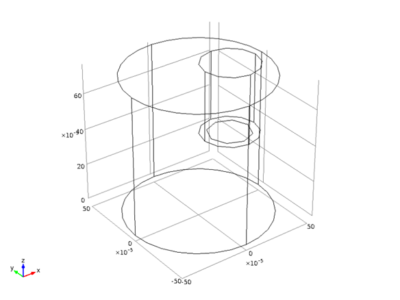

                                                    Hi Ivar,
Thank you very much for your reply. At present, I do not have access to comsol. So I did not try the way you mentioned.
Does "geometry finish union" work differently than the "union" from "Boolean operations" ?
Because I used the "union" from "Boolean operations" . In this case, I could not edit internal boundaries (to specify the capillary walls).
Can you please send me a simple example if you have some time?
Thank you.
                            Hi Ivar,
Thank you.

indeed the finish - union is first making an union of all objects, then it analyses the objects and transform them into entities, which are numbered, identified, overlapping objects are split and duplicates removed. Common boundaries are also grouped, as by default there is a continuity of the flux over such boundaries
now in V4 COMSOL accepts certain "thin film" BC on internal boundaries, so one do not always need to use the Finish - assembly mode and define all related identity and special physics pairs by hand. Note you can do some geometry union operations before the final assembly, the the "assembly" criteria is only applied to the non united objects, which reduces the number of pairs to define

In fact, continuity of flux over interior boundaries is my problem. It should be wall bc at the interior boundaries.
May be I am not able to understand something.
Currently I subtracted capillary from the tube and in this case I am able to chose the wall bc. I use laminar outflow bc at the capillary inlet. Results make sense. But  someday I may need to solve the physics in capillary also.

you have the "Geometry - Finish Assembly" mode to dedouble all common boundaries, then you can link them with some how brew physics, not necesarily respecting only the continuity. This is what COMSOL does implictely for its internal "thin layer physics"
Check the help and the doc on the "Finsih Assembly" for further examples
