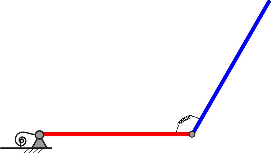

My problem is to simulate two beams connected at an included angle. The diagram is shown below.
pic
The first beam is hinged on the ground, and the rotation is restrainted by a rotation spring with stiffness coefficient . The second beam is connected with the first beam via a pin joint and the rotation stiffness is .
In other FEM softwares, I know I can use MPC to achieve the connection between these two beams. But I didn't find a similar functionality in COMSOL. How can I simulate my problem. My goal is to investigate the effect of the included angle and spring stiffness on the natural frequencies of this system, so I want to perform a parametric study. A simple example file would be highly perfered and appreciated.

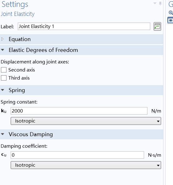

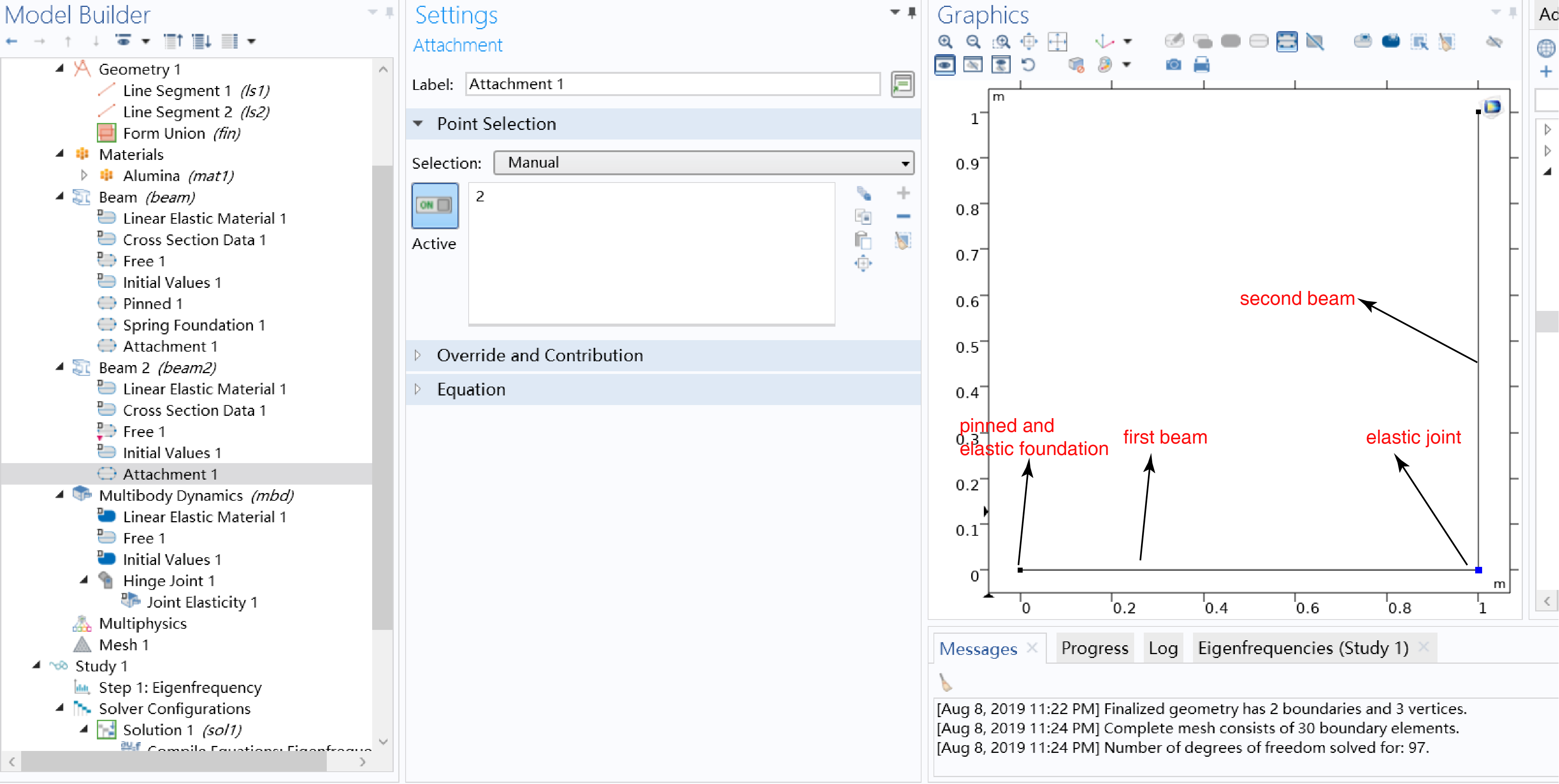

Dear Henrik Sönnerlind,
Thanks for providing me the solution. I tried your method. I use two lines to represent the two beams. Then the first beam is hinged to the ground by using the pinned and spring foundation. The first attachment is at the right end of the first beam while the second attachment is at the left end of the second beam. The two beams are connected via the MBD hinge joint. But when I solve the problem, the error message shows that comp1.beam.att1.phi variable is not defined. Can you tell me the possible reason and how to solve it? https://i.ibb.co/xFwpckc/001.png
Undefined variable. - Variable: comp1.beam.att1.phi - Global scope Failed to evaluate Jacobian of expression. - Expression: comp1.mbd.hgj1.uc_src-comp1.mbd.hgj1.uc_dest
Thanks.

The last question is answered in https://www.comsol.com/forum/thread/240483/use-multibody-dynamics-module-to-simulate-two-elastically-connected-beam
