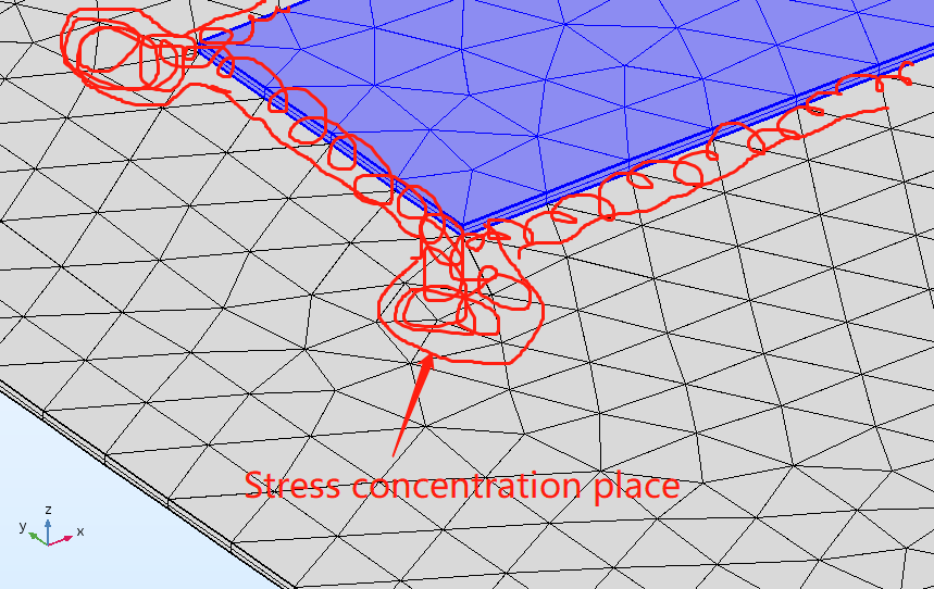

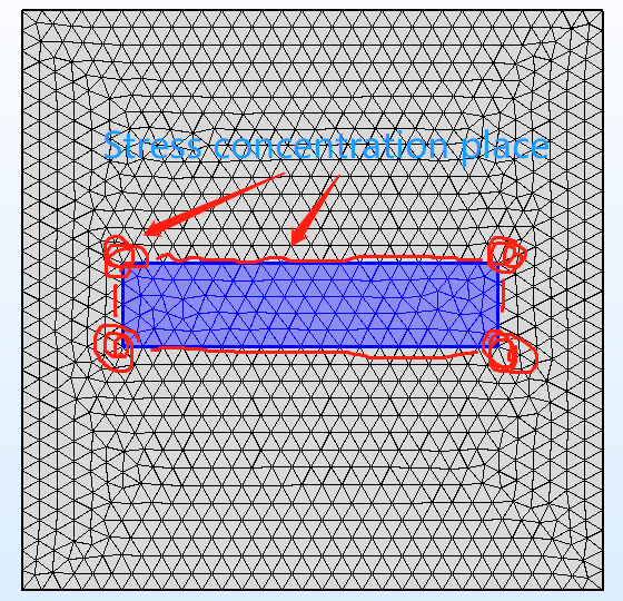

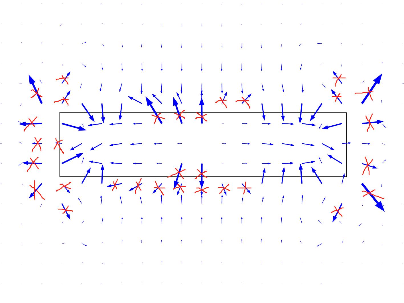

In my model, the stress concentration region is the joint part of two steps, as shown in the first two figures in the attachment. The third figure shows the chaotic energy flux vector field in the stress concentration region, and the vectors marked with red "x" are incorrect ones (Amplitude and direction are all incorrect). The model is consist of two layers of panels that are stuck together and under excitation. So stress concentration phenomenon will happen near the margin of the smaller block on the bigger block. Do you have any suggestions to solve this kind of stress concentration problem?
Thank you very much! Look forward to your reply.
