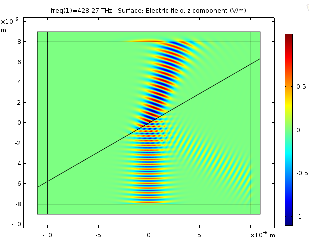

one refracted beam in roughly
Is the attached figure what you expect?

>one refracted beam in roughly Is the attached figure what you expect?

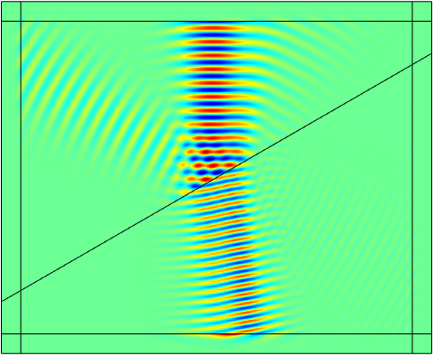

correct. At least qualitatively it makes more sense to me. When I run the above simulation I posted, I get the 'wrong' E-field in the attached fugure.
>>one refracted beam in roughly > >Is the attached figure what you expect? correct. At least qualitatively it makes more sense to me. When I run the above simulation I posted, I get the 'wrong' E-field in the attached fugure.
The default direction of incidence is positive y, so the Gaussian beam illuminates from the bottom to the top. That's what you got. The easy fix is just the change of sign for the wavevector.

>>>one refracted beam in roughly >> >>Is the attached figure what you expect? > >correct. At least qualitatively it makes more sense to me. When I run the above simulation I posted, I get the 'wrong' E-field in the attached fugure. The default direction of incidence is positive y, so the Gaussian beam illuminates from the bottom to the top. That's what you got. The easy fix is just the change of sign for the wavevector.
