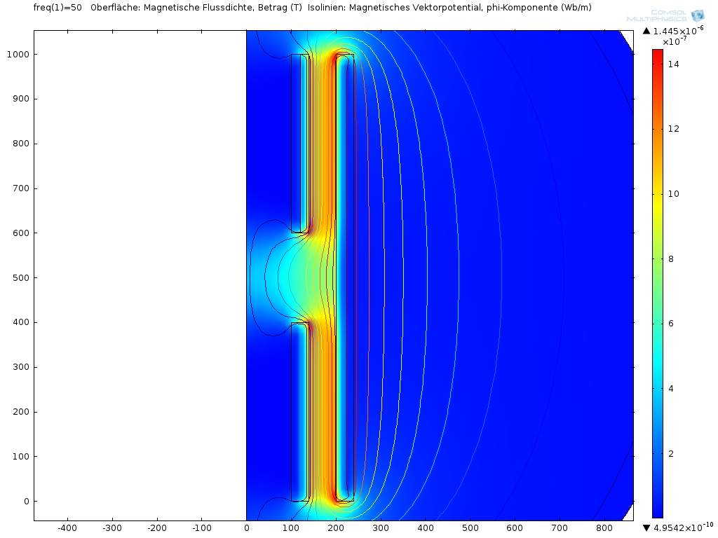

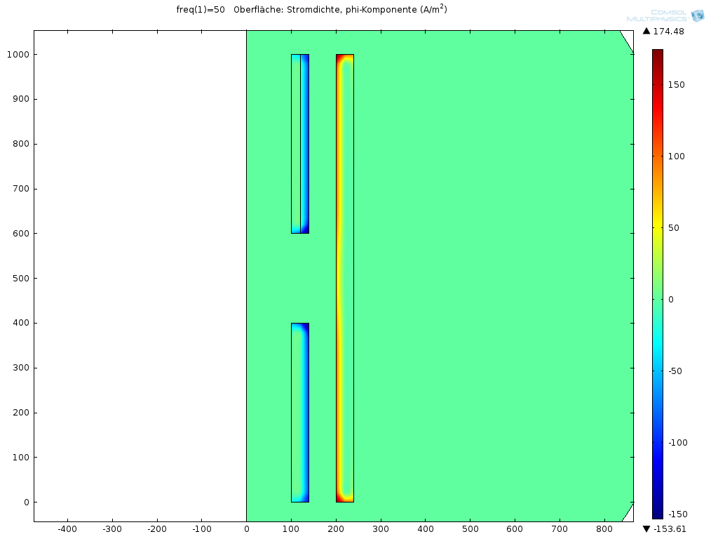

Posted: 1 decade ago 2012/03/30 20:26 JST
in MEF you can check, if Transition Boundary Condition is working for you.
For frequency domain I have modified your example (MEF is not for transient).
Ralf
Hi, in MEF you can check, if Transition Boundary Condition is working for you. For frequency domain I have modified your example (MEF is not for transient). Ralf
