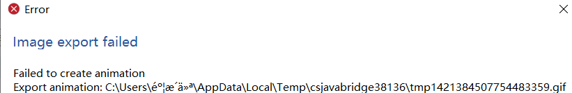

I am simulating a 2D model of pm motor. I need to export the animation as a file. While I exported the animation, it showed the following error, which shows as the image upload 'error'.

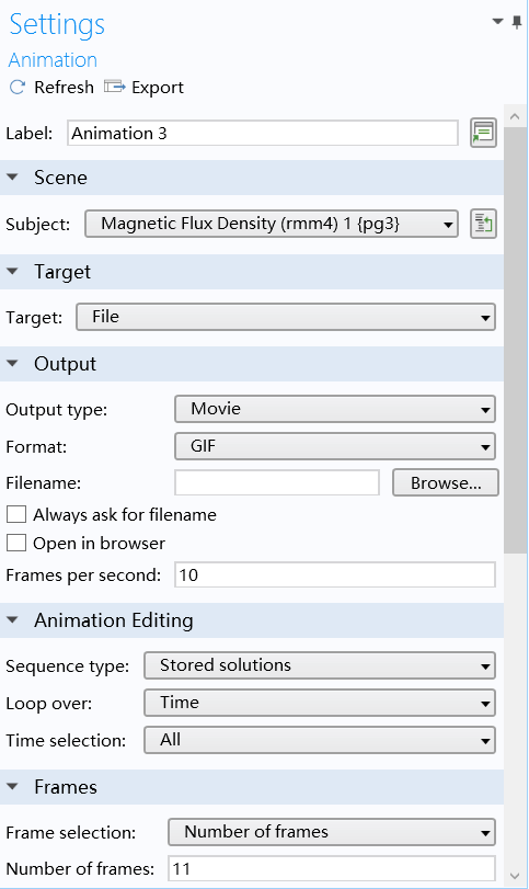

But, I have an assumption, in the Setting module (the upload image animation setting) , there is a browse button, I had change the path of the file, it still falied. Should I change the filename or other ways?

I suspect that the reason for the error is that your user name contains non-ASCII characters. This can be a problem when the program creates temporary files (in this case images for the animation). To fix this you can set the directory for temporary files explicitly: E.g., comsol.exe -tmpdir C:/temp.
