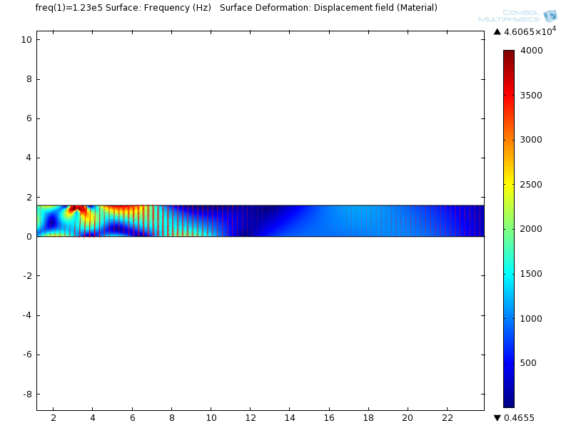

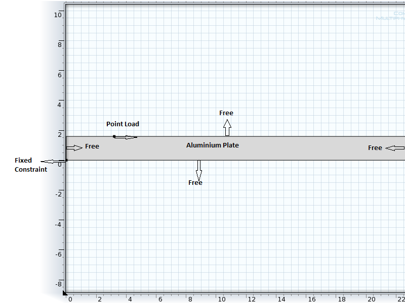

Hi Rohan,
I went through the paper that you listed in detail and then tried modeling it exactly according to the
specifications in the paper. The metal i have taken is Aluminium with specs that of the paper.
E=70GPa, den=2.7gm/cm^3, v=0.33, thickness=1.59mm and applied force 3.2mm from the y axis.
I've used Structural Mechanics as the Physics and time dependent study.
A point load is used to give the point force as F*sin(wt)*(sin(wt/10))^2 *(t<10*pi/w).
A fixed constraint point as a BC to the origin. The remaining geometry i have used free boundary condition.
I ran this for 100kHz frequency.
My question is it possible to give a frequency sweep in a time dependent study?
If no, is how can u simulate the graphs for the x component of velocity and y component of velocity as a function of frequency?
Ive not quite got the simulations results that 100kHz should be showing compared to the what the paper shows.
Ive attached the model that ive created in 4.2.
Also attached is the pic of the geometry that i have created.
I would be very helpful if you could upload the model that u created.
