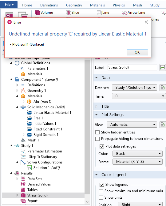

                                                    Can you post your .mph file? A screenshot doesn't let other users poke around to see what may be going on elsewhere in your model set-up. If the file is too large to upload, you can clear all solutions and save it under a different name before posting that - it'll be much smaller.

                                                    Hello DV,
The file you posted doesn't seem to have the "Parameter estimation" node set up. Maybe it's the wrong file?
If I disable that node, the plot is generated without problem.
I also noticed that in the screenshot you attached in your first post there's a reference to a time t=0 in data set 1, which seems wrong since you don't have a transient analysis in the model. Perhaps it was left over from a previous iteration of your model?

                                                    The model you uploaded is not complete. It stops when 'compiling equations'.

                                                    Hi Jeff,
I just got to looking at it again.
The parameter estimation can be disabled, not really sure why it's there.
I just wanted to create the von mises plot as my next step. You said that it runs fine when you disable the parameter estimation but I still get the same error message.

                                                    Hi D V,
Your file still contains that dubious reference to a time t=0 in the Stress plot group, so I simply solved the model (i.e. I right-click on the Study node and select Compute) and the plot comes out nicely.

                                                    Ah right, I got it to work. I think the problem was indeed the t=0.
Thank you very much!
