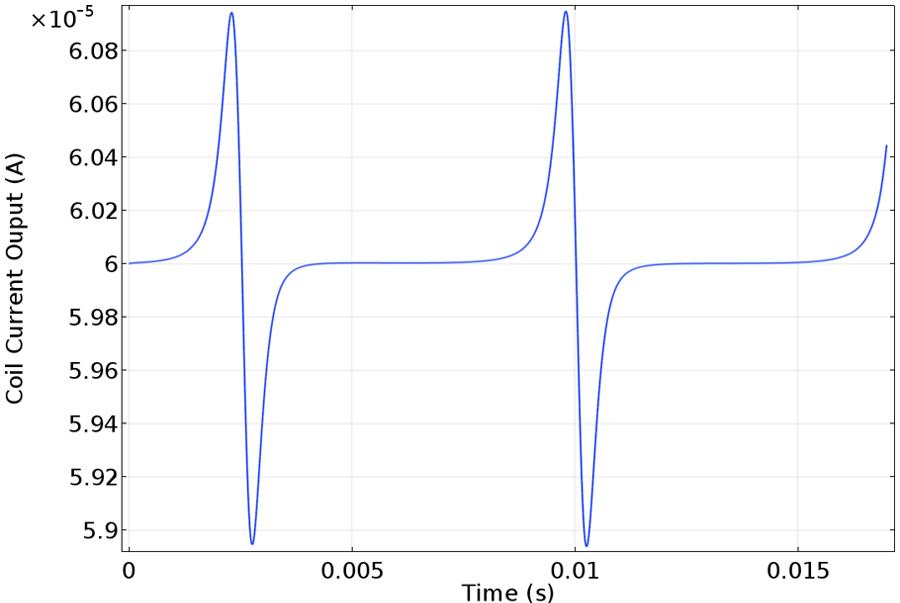

Posted: 6 years ago 2019/10/03 0:37 GMT-4
I have now used rotating machinery, Everything looks fine but my coil output current for simulatio is different than the required output as in attached image below.
