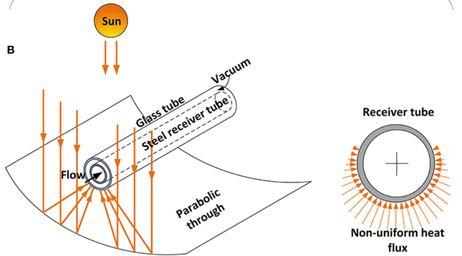

as you can see in the picture, i'm trying to simulate a parabolic trough and because of the way it is designed, most of the concentrated rays are at the bottom of the receiver.

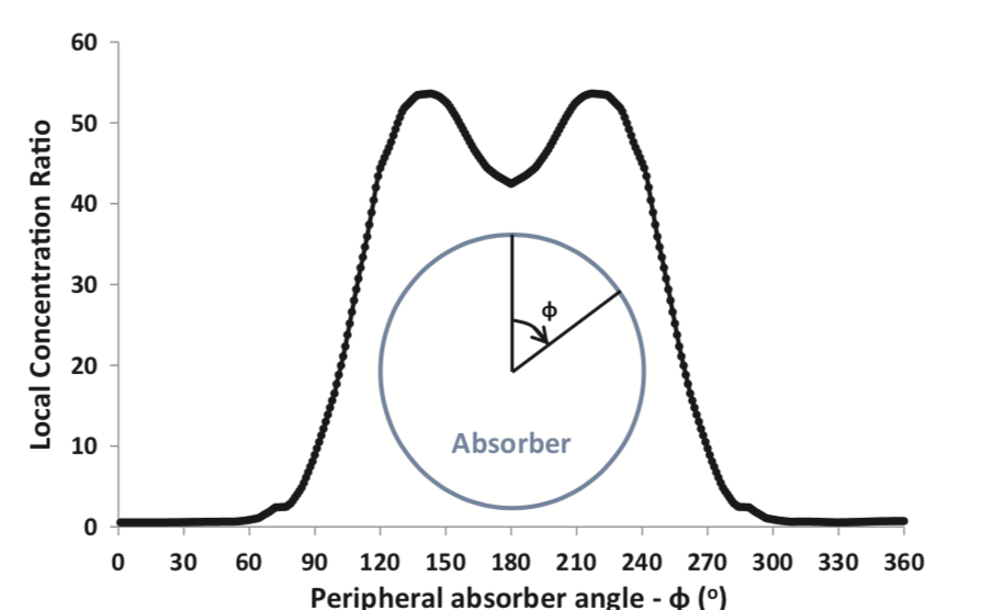

The variation of the concentration of the heat flux can be shown in the second figure below.

In this case, rather than artificially subdividing the geometry into 360 pieces, you're much better off defining an Interpolation function using your data (which I presume you have in a file of some kind) and then calling it to apply it on the surface as a function of the angle. See the attached toy file. I defined a cylindrical coordinate system sys2, which I use when calling the interpolation function. I typed in the values that my interpolation function takes, but you can call the data from a file also.
I hope this helps.
