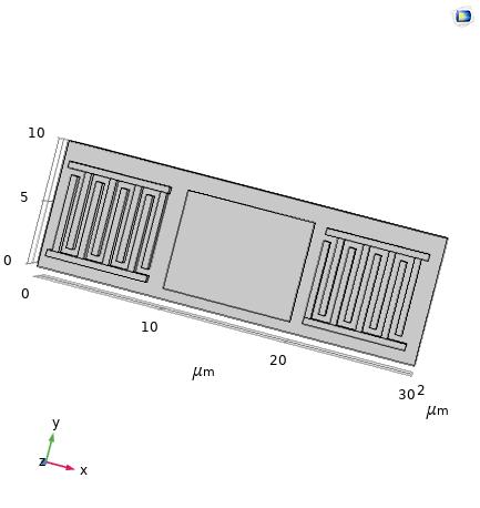

Iam herewith attaching the image of my device for reference as there is a problem with the file upload. pls suggest some way to upload the file I will upload the file and I can have some suggestions from you.
Is frequency domain analysis is same as frequency dependent analysis?
As the configuration of IDT is in Interdigitated in fashion ho wto provide voltage as per your suggestion.Pls let me know.Iam eagerly waiting for your reply.
Iam herewith attaching the image of my device for reference as there is a problem with the file upload. pls suggest some way to upload the file I will upload the file and I can have some suggestions from you. Is frequency domain analysis is same as frequency dependent analysis? As the configuration of IDT is in Interdigitated in fashion ho wto provide voltage as per your suggestion.Pls let me know.Iam eagerly waiting for your reply.

I can't tell what the problem is with file upload. The image is no help in figuring out what your problem is.
In general I advise setting up and solving a simpler, smaller 2D problem before attempting a 3D solution.
