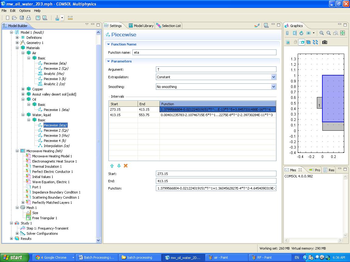

I am trying to find out some relationship of viscosity with temperature and thermal conductivity plus dielectric constant with temperature. But some one suggested me to define the material properties in the way being defined by the built in materials, please find attached the images (water1.jpeg for the properties shown for water defined as built in function, highlighted is the dynamic viscosity, second image is function of temperature.jpeg and shows how dynamic viscosity has been defined as a function of temperature). I am not sure how to incorporate such functions in my model for oil, can you please suggest some thing?
Secondly as you mentioned that at high temperatures, viscosity drops much and the natural convection should also be incorporated. If I find some temperature -viscosity relationship for oil and include it in the model for oil properties, will it not cover this phenomenon of natural convection? Should I have to include it as another parameter or function?
Many thanks for your feedback!
JazakAllah.
Thanks a lot brother for answering! I am trying to find out some relationship of viscosity with temperature and thermal conductivity plus dielectric constant with temperature. But some one suggested me to define the material properties in the way being defined by the built in materials, please find attached the images (water1.jpeg for the properties shown for water defined as built in function, highlighted is the dynamic viscosity, second image is function of temperature.jpeg and shows how dynamic viscosity has been defined as a function of temperature). I am not sure how to incorporate such functions in my model for oil, can you please suggest some thing? Secondly as you mentioned that at high temperatures, viscosity drops much and the natural convection should also be incorporated. If I find some temperature -viscosity relationship for oil and include it in the model for oil properties, will it not cover this phenomenon of natural convection? Should I have to include it as another parameter or function? Many thanks for your feedback! JazakAllah.
Posted: 1 decade ago 2011/10/26 10:31 GMT-4
Instead of providing linear regression equation in piece-wise function, you can use interpolation as it was done for speed of sound properties of water.
For taking into account of the convention, you need to use solve Navier-Stokes equations. I would recommend you to first set the RF physics right as convection will not change your microwave power distributions in the domain. alter on you can add up more physics.
Sohan

Thanks a lot Sohan for answering!
Would it work fine if I define all of the properties of oil as interpolation without even one of them as piece wise as I see in the built in functions they use mixture of interpolation and piece wise?
Secondly, would you please elaborate your saying about convection?
What do you mean by saying "Set your Physics Right and After on you can change your Physics"?
Many Thanks in advance for your response!
Thanks a lot Sohan for answering! Would it work fine if I define all of the properties of oil as interpolation without even one of them as piece wise as I see in the built in functions they use mixture of interpolation and piece wise? Secondly, would you please elaborate your saying about convection? What do you mean by saying "Set your Physics Right and After on you can change your Physics"? Many Thanks in advance for your response!
Posted: 1 decade ago 2011/10/26 12:38 GMT-4
Yes, it should work.
In developing multi-physics model, first set and solve the most important physics. In your case microwave interaction with oil bearing materials. First set RF wave and solve the EM field using frequency domain solver for your domains. When you obtain the dissipated power density pattern as per your experiences/ intuition, next step to set other physcis such as conduction and convection to take into account of conduction, and convection. Here you will need temperature dependent material properties.
Hope it helps,
Sohan
Yes, it should work. In developing multi-physics model, first set and solve the most important physics. In your case microwave interaction with oil bearing materials. First set RF wave and solve the EM field using frequency domain solver for your domains. When you obtain the dissipated power density pattern as per your experiences/ intuition, next step to set other physcis such as conduction and convection to take into account of conduction, and convection. Here you will need temperature dependent material properties. Hope it helps, Sohan

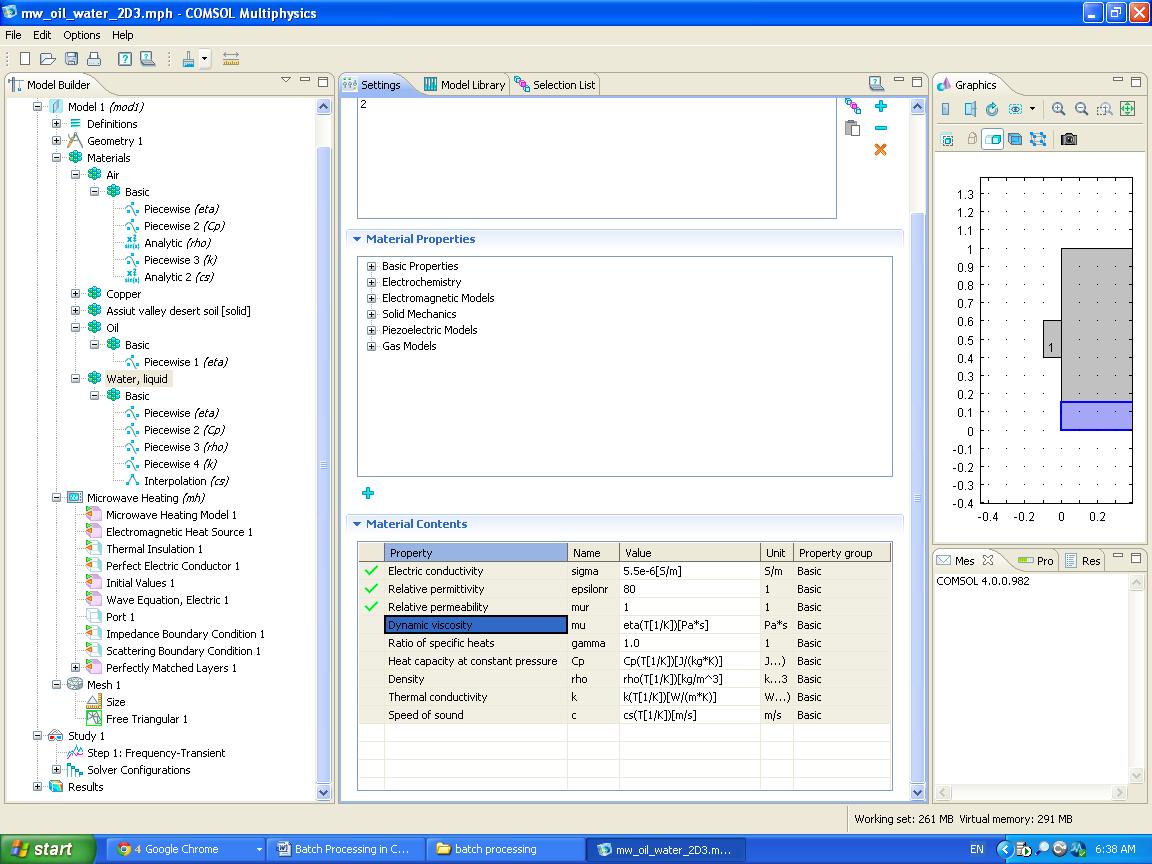

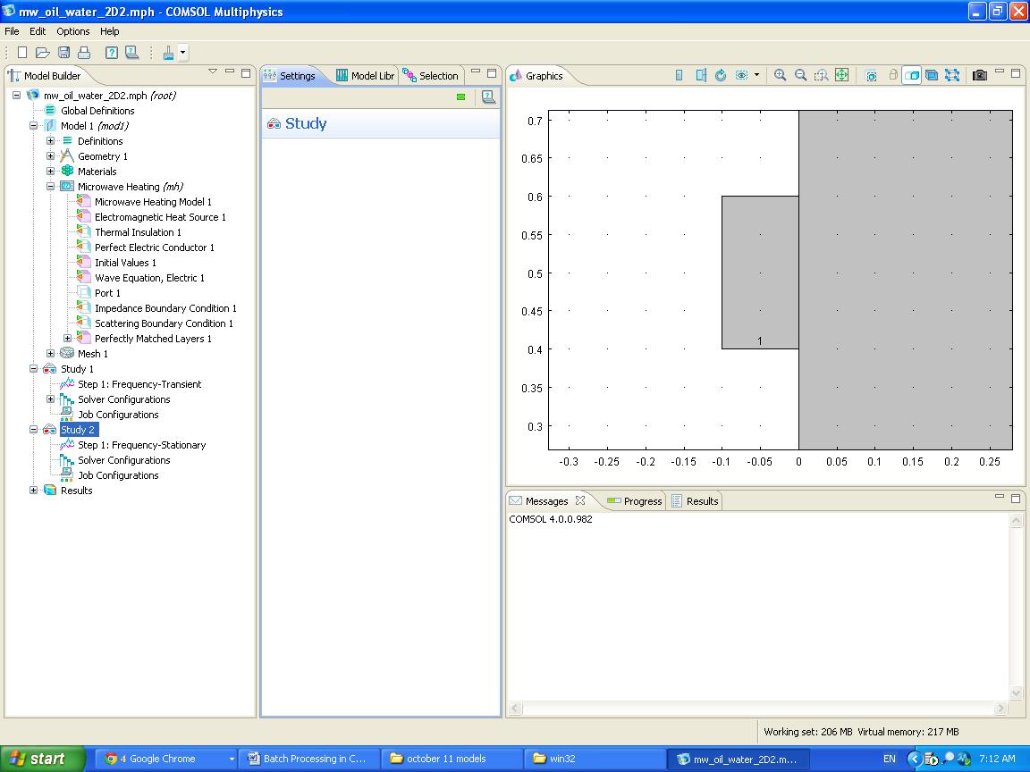

I tried to setup an other study but I have the properties of the materials as the same as you can see in the attached image. I want to run the first study with some settings of the material and then use the result of first study as base point for the second study.
If I proceed with simulation of first study and then change the settings of material properties manually and carryout the second study, is it the same what I want? I mean is COMSOL using the results of my first study as starting point or initial conditions for the second study, if not then how can I do that?
For the dielectric constant change with temperature, if I define my dielectric constant as interpolation function by inserting a table (different dielectric strength for different temperature) in the input of dielectric properties of oil, and simulate isn't it being considered as dynamic dielectric constant by COMSOL? Will the results of my simulation will incorporate the change in dielectric strength?
Thanks a lot once again for your time and support, JazakAllah!
Thanks a lot brother for your answer! I tried to setup an other study but I have the properties of the materials as the same as you can see in the attached image. I want to run the first study with some settings of the material and then use the result of first study as base point for the second study. If I proceed with simulation of first study and then change the settings of material properties manually and carryout the second study, is it the same what I want? I mean is COMSOL using the results of my first study as starting point or initial conditions for the second study, if not then how can I do that? For the dielectric constant change with temperature, if I define my dielectric constant as interpolation function by inserting a table (different dielectric strength for different temperature) in the input of dielectric properties of oil, and simulate isn't it being considered as dynamic dielectric constant by COMSOL? Will the results of my simulation will incorporate the change in dielectric strength? Thanks a lot once again for your time and support, JazakAllah!
Posted: 1 decade ago 2011/10/31 10:31 GMT-4
There is no need to simulate frequency-stationary study. Instead of it, I recommend you to add RF module and perform study with frequency domain solver. This will take material properties at initial temperature. Once you get satisfactory result showing power density, solve the coupled MW heat transfer using transient solver.
Sohan

Hi Robert,
Can you please let me know, what 'y' stands for in the following expression for E-field of Microwaves?
Ez= cos(pi*y/0.062)[V/m]
This expression is given in the Microwaves Oven Heating of Potato model in COMSOL but in my case it is showing an orange color of expression (it means there is an unknown in the expression). I tried to remove y from the expression and the expression color became black (OK). But now it does not include 'y' which I believe mentions the position of microwaves source w.r.t. y-axis.
By the way, my model is 2-D, is it fine if I apply a 3D Electric field i.e. Ex=0, Ey=0, and Ez=cos(pi*y/0.062)[V/m]?
Thanks for any response!
Hi Robert, Can you please let me know, what 'y' stands for in the following expression for E-field of Microwaves? Ez= cos(pi*y/0.062)[V/m] This expression is given in the Microwaves Oven Heating of Potato model in COMSOL but in my case it is showing an orange color of expression (it means there is an unknown in the expression). I tried to remove y from the expression and the expression color became black (OK). But now it does not include 'y' which I believe mentions the position of microwaves source w.r.t. y-axis. By the way, my model is 2-D, is it fine if I apply a 3D Electric field i.e. Ex=0, Ey=0, and Ez=cos(pi*y/0.062)[V/m]? Thanks for any response!

Thank you Ivar for your response!
I made all the changes necessary to change the color of orange expressions according to your instructions and the warnings have been removed. I did this because I was thinking that these warnings might be the cause for this error of stiffness matrix. I run the simulation again but still the same error persists. As it is mentioning mod1.E10, mod1.E20,mod1.E21 and Mod1.Ez, I think it is an error for the E-field, is it so? If yes, how can I remove it becasue there is no complexity involved in definition of E-field it is just as simple as Ex=0, Ey=0 and Ez=cos(pi*y/0.062[m])[V/m].
Is it possible that I am getting this error because of the definition of E-field in z component while I am using just a 2D model?
Undefined value found.
- Detail: Undefined value found in the stiffness matrix.
There are 1160 equations giving NaN/Inf in the matrix rows for the variable mod1.E10
at coordinates: (0.0018763,0.00166667), (0.0037526,0.00333333), (0.00382242,0), (0.00757502,0.00333333), (0.00764484,0), ...
There are 290 equations giving NaN/Inf in the matrix rows for the variable mod1.E20
at coordinates: (0.00569872,0.00166667), (0.0018763,0.005), (0.00555907,0.00833333), (0.00938149,0.005), (0.0619473,0.00333333), ...
There are 290 equations giving NaN/Inf in the matrix rows for the variable mod1.E21
There are 871 equations giving NaN/Inf in the matrix rows for the variable mod1.Ez
at coordinates: (0,0), (0.0114673,0), (0.00573363,0), (0.00281445,0.0025), (0.0056289,0.005), ...
and similarly for the degrees of freedom, NaN/Inf in the matrix columns
Thanks in advance for any of your response!

Muhammad Mohsin Rehman
Posted: 1 decade ago 2011/11/27 1:43 GMT-5
Thanks a lot Sohan,
Unfortunately I am unable to open the file you sent as I think because of the version (I am using version 04a).
I did the same as you suggested. I have a 2D rectangular port and one of its boundaries is excited by using the input Power of 50 KW, Electric field as Ex=0, Ey=0 and Ez=cos(pi*y/0.062[m])[V/m]. Then comes the propagation constant beta which has been defined as: 2*pi/c_const*sqrt(freq^2-c_const^2/(4*0.062^2))
This is just in the same way as it was defined for microwaves oven model. Now when I simulate a layer of oil and a layer of water connected together then I get some temperature distribution but when I define one layer of water as sandwiched between two layers of oil, in that case it gives the error mentioned below. Can you please suggest something, what could be the potential cause of this error and how it can be rectified. By analyzing the error, I have come to know that it is related to E field because it is mentioning mod1.E10,20 etc. and secondly it has something to do with the layer of water as the co-ordinates mentioned are referring to the location where the layer of water is located. But I am not sure what kind of error is it. Can you please elaborate what E-field can be defined reasonably for a 2D wave guide? In addition, what should be the boundary condition between oil and water normally?
Thanks a lot for any help.
Posted: 1 decade ago 2011/11/27 23:41 GMT-5
Thanks a lot Sohan for so detailed reply!
I agree with you that by defining a rectangular port, I do not need to define the E-filed and propagation constant but I am using the user defined port in which I will have to take care of the dimensions of rectangular wave guide by providing the propagation constant. Definition of the dimensions will also set the cut off frequency but I am not sure what kind of E-field I can define?
I have checked for every boundary and domain and it seems good to me but still I am not able to get the heat distribution. I have also activated the union. Layers have been defined just as rectangles with different dimensions.
Please have a look on the attached model and rectify me where I am wrong.
Thanks for the feedback once again!

I am also trying to convert water into steam at a specific temperature (say 100 degree Celsius). I could not find any latent heat of vaporization in COMSOL and was wondering how can I define it.I have just a block of water and I am heating it with microwaves. It should absorb the heat and water should be converted to steam.
I also tried to change the specific heat capacity of water as suggested by you to Timo last time but on checking its specific heat capacity I found it defined as piece wise format:
Start 273.15 , End: 553.75 and Function: 12010.1471-80.4072879*T^1+0.309866854*T^2-5.38186884E-4*T^3+3.62536437E-7*T^4
How can I change this expression for it to include specific heat capacity very high near the boiling point of water?
Can you please suggest some thing?
Thanks.

Posted: 1 decade ago 2011/12/27 21:12 GMT-5
There are several ways to do that. One way is to add to Cp a built-in “Rectangle” COMSOL function that acts around 100 Celsius (say from 98 to 102). The function value should be zero below 98 and above 102, and equal to the latent heat divided by 4 between 98 and 102. Make sure as Ivar mentioned to select a smooth function and make sure also that the time stepping is small enough to not skip over that narrow temperature range.
Nagi Elabbasi
Veryst Engineering
There are several ways to do that. One way is to add to Cp a built-in “Rectangle” COMSOL function that acts around 100 Celsius (say from 98 to 102). The function value should be zero below 98 and above 102, and equal to the latent heat divided by 4 between 98 and 102. Make sure as Ivar mentioned to select a smooth function and make sure also that the time stepping is small enough to not skip over that narrow temperature range. Nagi Elabbasi Veryst Engineering

Posted: 1 decade ago 2011/12/28 0:47 GMT-5
Thanks brother!
I have tried to define the rectangle function but I was only able to define it in "Global Definitions" or "Definitions" section. I could not find a way to apply this function to Cp. In addition it was automatically taking the highest value as 1 inside the duration. How can I change this value from 1 to "Cp/4" inside the interval?
Can you please suggest some thing by having a look on the attached file?
Thanks.
Thanks brother! I have tried to define the rectangle function but I was only able to define it in "Global Definitions" or "Definitions" section. I could not find a way to apply this function to Cp. In addition it was automatically taking the highest value as 1 inside the duration. How can I change this value from 1 to "Cp/4" inside the interval? Can you please suggest some thing by having a look on the attached file? Thanks.
Posted: 1 decade ago 2011/12/28 3:35 GMT-5
Hi there are two ways, once the function has been defined:
Either in the physics node ou define a UserDefined Cp with the expression referring to the different functions or parameters or typing you need, ...
or directly in the related material node in the Cp variable field
Hi Hi there are two ways, once the function has been defined: Either in the physics node ou define a UserDefined Cp with the expression referring to the different functions or parameters or typing you need, ... or directly in the related material node in the Cp variable field -- Good luck Ivar
Posted: 1 decade ago 2011/12/28 4:33 GMT-5
Thanks Ivar,
Still I am not getting it how to include the function value inside my Cp calculation? As you would have seen in the file I sent you last time, the built in Cp is being defined as a function of T as
with temperature ranging from 273 to 575 Kelvin.
Do you mean that I should define Cp as this function ranging from 273 to 371 Kelvin and 375 to 575 Kelvin while rectangular function will be defined as Cp/4 in between 371 and 375 Kelvin?
If so, it can also be defined as an interpolation function without caring for definition of rectangular function, am I right?
Please clarify...
Thanks.
Thanks Ivar, Still I am not getting it how to include the function value inside my Cp calculation? As you would have seen in the file I sent you last time, the built in Cp is being defined as a function of T as 12010.1471-80.4072879*T^1+0.309866854*T^2-5.38186884E-4*T^3+3.62536437E-7*T^4 with temperature ranging from 273 to 575 Kelvin. Do you mean that I should define Cp as this function ranging from 273 to 371 Kelvin and 375 to 575 Kelvin while rectangular function will be defined as Cp/4 in between 371 and 375 Kelvin? If so, it can also be defined as an interpolation function without caring for definition of rectangular function, am I right? Please clarify... Thanks.
Posted: 1 decade ago 2011/12/28 12:16 GMT-5
if you want to refer to a function, only reated to a material property, you can create/add a new material, then right click the "Basic" node and add local fuctions therein, and refer to them in your material property expressions. Check how it's don ein the "complex" materials inthe built-in material library, (i.e. "air"),
with the interpolation function you can use higher order interpolation polynomial to make it rather "smooth", following the values as Nagi explained
Hi if you want to refer to a function, only reated to a material property, you can create/add a new material, then right click the "Basic" node and add local fuctions therein, and refer to them in your material property expressions. Check how it's don ein the "complex" materials inthe built-in material library, (i.e. "air"), with the interpolation function you can use higher order interpolation polynomial to make it rather "smooth", following the values as Nagi explained -- Good luck Ivar
