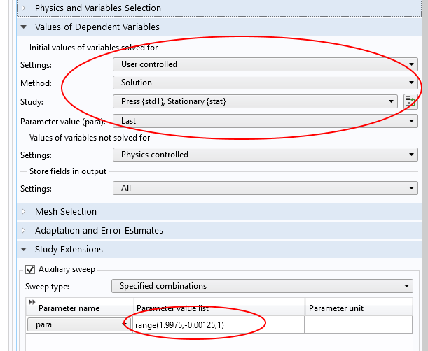

In your second study, you should have setting for the "Step1: Time-Dependant" node something similar to the attached for the "Values of Dependent Variables" settings.
(My example is for a Stationary study, but the principle is the same). Obviously, you change your Auxiliary sweep parameters to range(2601,1,3000) if you want to increment the additional 400s in steps of 1s.
Note that you can combine the 2 solutions (for example if you wanted to animate a plot from 0s to 3000s), by using the "Combine Solutions" functionality.
In your second study, you should have setting for the "Step1: Time-Dependant" node something similar to the attached for the "Values of Dependent Variables" settings. (My example is for a Stationary study, but the principle is the same). Obviously, you change your Auxiliary sweep parameters to range(2601,1,3000) if you want to increment the additional 400s in steps of 1s. Note that you can combine the 2 solutions (for example if you wanted to animate a plot from 0s to 3000s), by using the "Combine Solutions" functionality.
