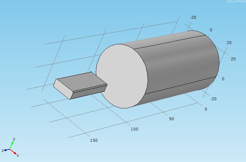

I need to make a connection between a round tube and a square tube (with rounded corners).
I've got a cad design but there he is taking to much surfaces into account or is simply deforming the design.
So I'm trying to draw myself the system.
How can I say to comsol that he needs to make the connection between the round tube and square tube?

Hi Ivar,
I tried somethings but I didn't manage to complete it.
A cone could be set up on the cilinder.
But how can I change the upper surface of the cone (I tried intersection but this must be done in a workplane? how can I get the two surfaces in the same workplane?)
I only capable of having a round cone.
Can I extrude the square surface into a round surface over a certain distance?

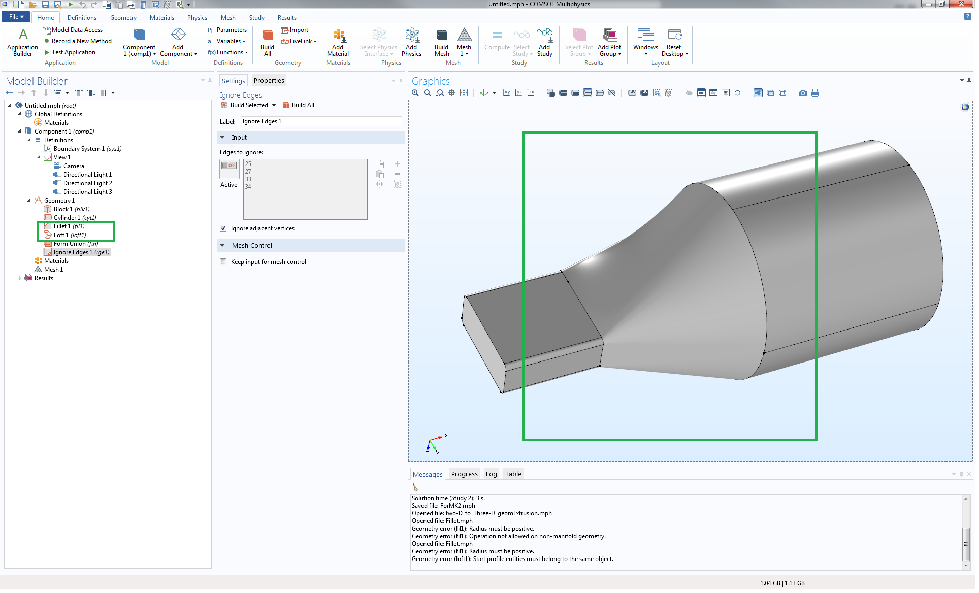

Jeff Hiller COMSOL Employee
Posted: 10 years ago 2015/12/05 0:31 JST
The Design Module (which did not exist when this thread was started) includes, among other things, two capabilities that makes creating this geometry a cinch:
- 3D filleting
- Lofting
I am attaching a screenshot illustrating those capabilities on your geometry.
The Design Module (which did not exist when this thread was started) includes, among other things, two capabilities that makes creating this geometry a cinch: - 3D filleting - Lofting I am attaching a screenshot illustrating those capabilities on your geometry. Best, Jeff
