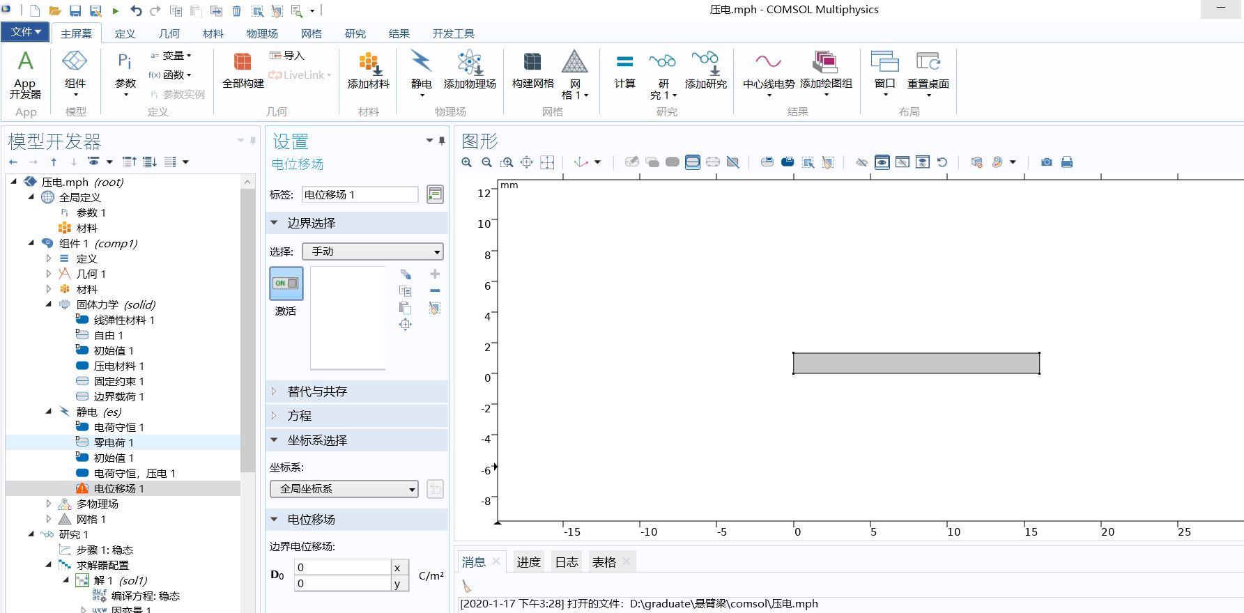

dear! I am doing a subject of piezoelectric beams subjected to lateral forces,and i want to constrain electrical displacement only in y direction,but in comsol i find i need to constrain both x and y direction,like the graphic in annex,can you tell me how to solve it?

no,i mean 'electric displacement' in the piezoelectric module,and it's symbol is expressed as Dx
>Do you mean *mechanical* displacement? no,i mean 'electric displacement' in the piezoelectric module,and it's symbol is expressed as Dx

This boundary condition is not a 'constraint'. Mathematically, it is a Neumann condition ('flux condition'). Thus, the value zero is the same as not prescribing it at all.

Hi, This boundary condition is not a 'constraint'. Mathematically, it is a Neumann condition ('flux condition'). Thus, the value zero is the same as not prescribing it at all. Regards, Henrik
