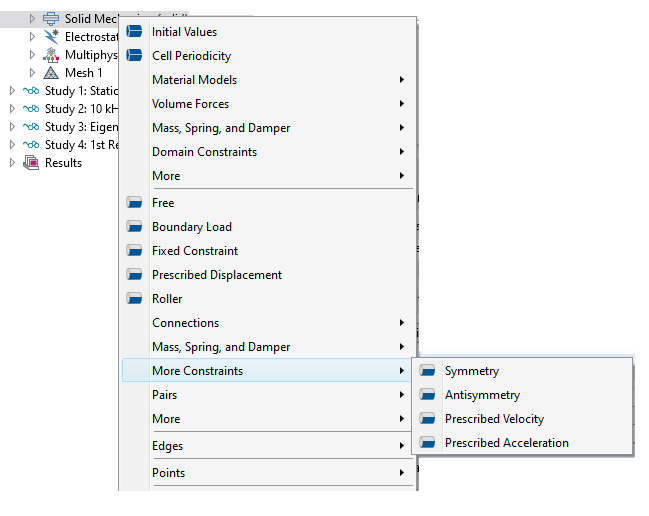

Symmetry BC is under More Constraints, as shown in the attached image.
Sergei
Hossein, Symmetry BC is under More Constraints, as shown in the attached image. Regards, Sergei

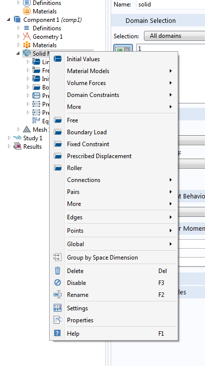

Thanks for your quick response. My COMSOL v5.0 doesn't seem to have "More Constrains". Please see the attached. Could be hidden?
Thanks, Hossein
Dear Sergei, Thanks for your quick response. My COMSOL v5.0 doesn't seem to have "More Constrains". Please see the attached. Could be hidden? Thanks, Hossein

The specialized boundary conditions under More Constraints are only present if you have the Structural Mechanics Module license. If not, you will have to express the boundary condition using the Prescribed Displacement node.
Henrik

Hi Hossein, The specialized boundary conditions under More Constraints are only present if you have the Structural Mechanics Module license. If not, you will have to express the boundary condition using the Prescribed Displacement node. Regards, Henrik

Thank you, I forced the symmetric boundary condition by using the Prescribed Displacement node, forcing zero out-of-symm.-plane displacement, and not imposing any other boundary condition on the symm. plane.
