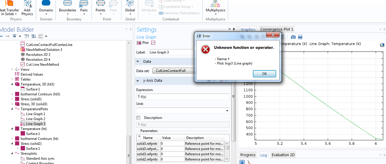

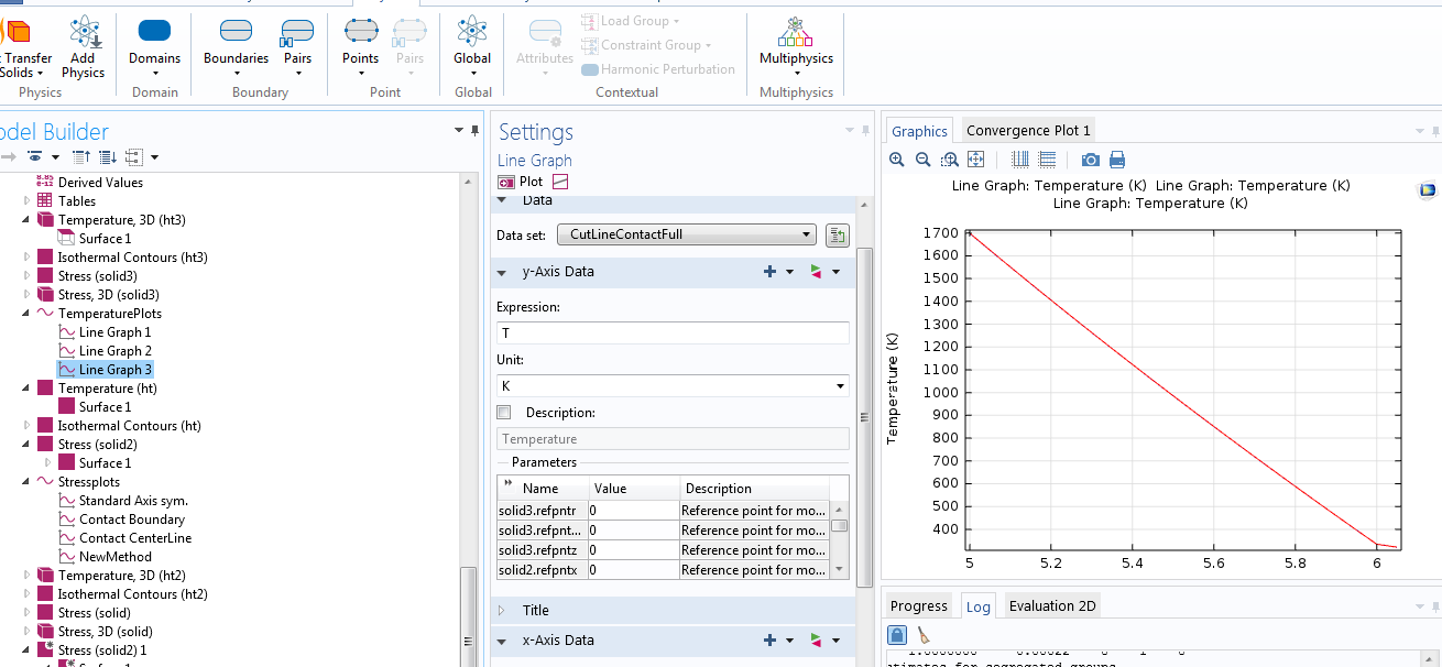

Hi , i calculate the analytic solution of the distribution of temperature in a hollow cylinder . I did the simulation in comsol , and i draw the temperature in comsol see figure 1
my problem now i want to calculate the error between the analytic solution and the simulation when i tried to define a function analytic in comsol and use it after , the comsol don't reconize it in the result section see figure 2
please help
thanks

Adam,
if you defined the function after solving the model you need to update the solution to make it available in the post processing.
Cheers Edgar

thanks , for help it works now ^_^
