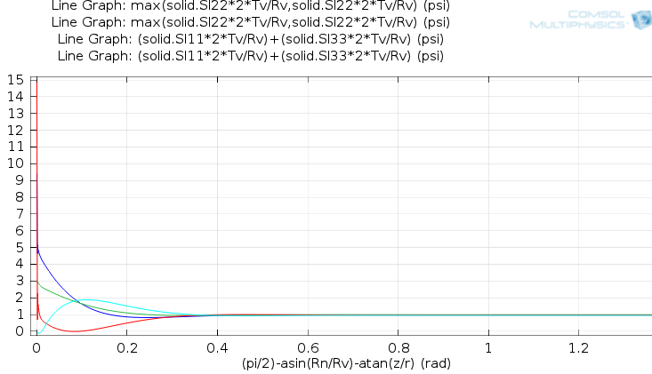

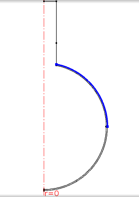

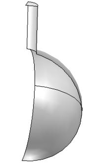

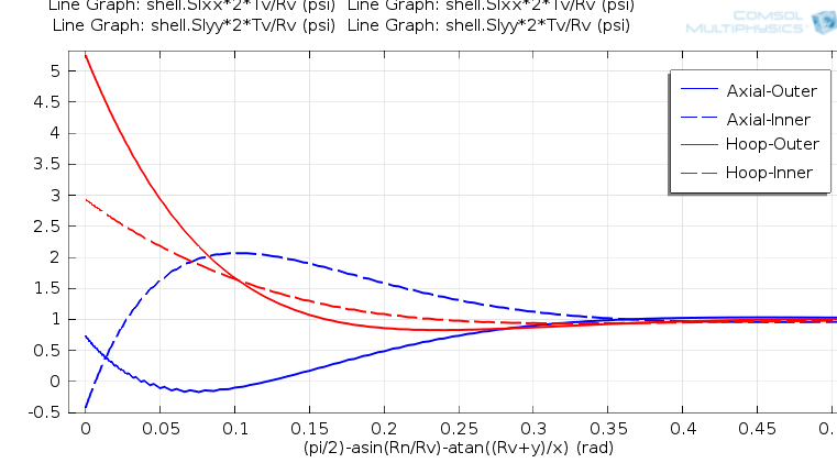

Hi all,
I need a guidance on the following problem. It is a pressurized spherical vessel (of radius Rv) with nozzle attachment of radius Rn. I need to use two approaches (the shell and solid element in comsol) to get variation of stresses (inner and outer hoop and axial/meridional). The shell solution works perfectly for me, having used 3D model (see attachment (a)). However, results of the stress variations along the indicated edges (in color) of the vessel and nozzle show singularity problem at the juncture when a 2D axisymmetric solid model (attachment (b)) is used. I used fillets to get away with this problem but it doesn't work well; different results (Fig. c) are obtained from those of the shell model (Fig. d). I'm using version 4.3a in my work. I would appreciate your kind help on this.
Thanks
Hi all, I need a guidance on the following problem. It is a pressurized spherical vessel (of radius Rv) with nozzle attachment of radius Rn. I need to use two approaches (the shell and solid element in comsol) to get variation of stresses (inner and outer hoop and axial/meridional). The shell solution works perfectly for me, having used 3D model (see attachment (a)). However, results of the stress variations along the indicated edges (in color) of the vessel and nozzle show singularity problem at the juncture when a 2D axisymmetric solid model (attachment (b)) is used. I used fillets to get away with this problem but it doesn't work well; different results (Fig. c) are obtained from those of the shell model (Fig. d). I'm using version 4.3a in my work. I would appreciate your kind help on this. Thanks
