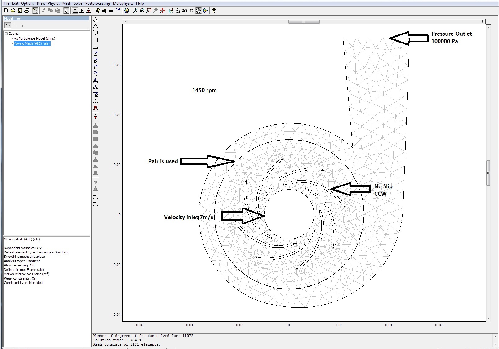

I'm trying to analyse the total transient force acting on impellers of a centrifugal pump. But unfortunately comsol couldnt find an intial solution. I'm getting an error as
"Failed to find consistent initial values." I used two methods described in various forums like "using a ramp function for rpm" and "finer mesh".
I set boundary conditions as in the attached figure.
Is there any suggestions?

The very first question that comes to my mind is how did you define the inlet velocity? Why is there an arrow in the middle of your domain?

And are you sure your blade curatures shoud not be inversed, the slope seems odd, for a centrifugal pump.
But you can also mirror the outlet to have it going "down", without changing other things in your

Dear Amir,
I defined the inlet velocity as a normal inflow option on the boundary that is shown by the arrow. Arrows are only for showing the boundaries. They are not in the model.

Dear Ivar,
I ran the analyse as you suggested but nothing changed. I think the curvatures of blades are correct. They are as in the literature.

for the curvature it might be OK, it just puzzled me at first.
To get it solving, I'm not sure what to propose, I got something like that running once in 3.5 a few years ago, not sure where I have it, and I have seen a v4 model pass by, again not sure where to look for that one, normally v4 should be better than V3.5 anyhow ;)

I am sorry I have not been clearer before. How did you define the inlet velocity? Has it got just a radial component? And if so did you define a vector field or just the overall scalar value? How did you define the rotating domain? Does it just rotate on its own or is it related to the inlet velocity?
There is no boundary mesh, I would recommend one. The overall mesh seems a bit coarse given the high value of rounds per minute.
Finally, in 4.2 you can't virtually get convergence for high rpms, i.e. turbulent flow, I don't remember about 3.5.
