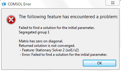

Hi experts,
I mat a problem when simulate a AC/DC model.
it came out as below:
Failed to find a solution for the initial parameter.
Segregated group1
Matrix has zero on diagonal.
Returned solution is not converged.
-Feature: stationary solver2(sol1/s2)
-Error: Failed to find a solution for the initial parameter.
any suggestions and help will be highly appreciated!

your image does not tell much about your model though ;)
But, a "0" on the diagonal often indicates some non defined BC's or not enough Boundary conditions to solve correctly. Now you have also a segregated solver case, perhaps the unknown comes from the 2nd step and has not been caclualted, or that the initial values are too far from the final solution.
I can suggest: a) recheck all your BCs for all physics, ahve you defined enough PER physics ? b) check the initial conditions, are these reasonnable ("0" is seldom the most reasonable, once you know the model, but in all generalit for any type of model "0" is an as good guiess, now I hope that you have a specific model and that you have done your home works with a few expecedd values where to pass ...) c) try to use adirect solver (or move all unknown to step 1 and suppress step 2... (requires more RAM, OK for small models on large PC)

Hey, I just spent an hour debugging a "Matrix has zero on diagonal" error. No problem with BCs. The problem was that I spelled the unit GHz as ghz. Units are case sensitive, it appears, and if you misspell them COMSOL can give a "zero on diagonal" error. Hope this helps somebody.

Units are indeed case sensitive, just like the rest of the program. When you think about it, it has to be that way, otherwise nothing would distinguish a megawatt from a milliwatt, a second from a siemens, etc.
Now, at least in the current version, version 4.3, if you type "ghz" as the unit for a quantity, that quantity gets highlighted in orange and the message "unknown unit" is displayed when you move the mouse over it. It's easy to spot and interpret.

normally "zero diagonal matrix" means you are missing some BC or initia lconditions such to make your equation set unique. I would start searching in that direction. Check carefully that al (and EACH)l dependent variable have enough BC's w.r.t. equation level/order. In multiphysics it's easy to forget one, and some physics have several dependent variables in addition to the one you are perhaps "onlx" using / interested in

Actually I have this problem in CFD. Running using Direct solver cleared it.
Would you say that this suggests that sometimes it arises not from missing boundary conditions?
