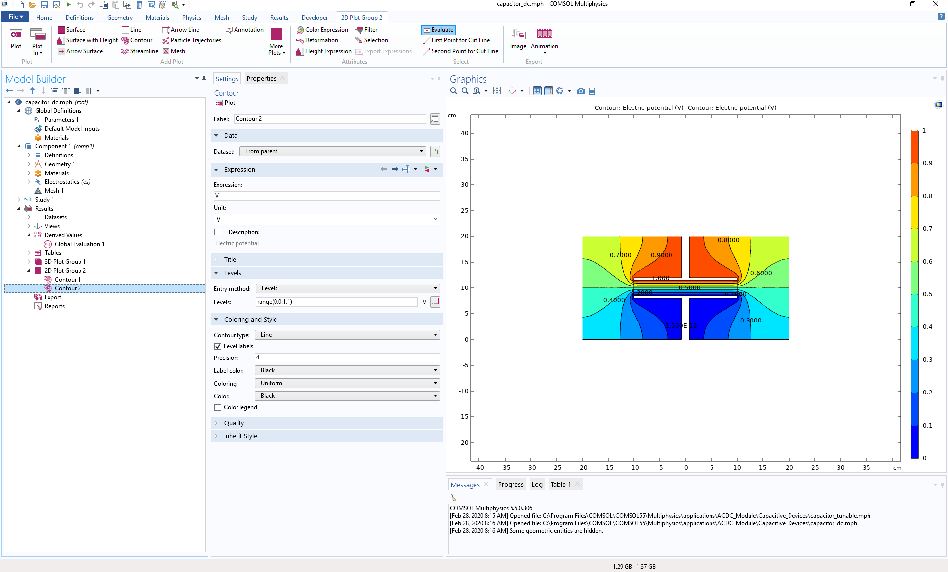

I tried generating the electric field plot and I did it successfully but how to have equipotential lines contour for the same structure?

The parallel plate capacitor model that I mentioned above (and which you can also find inside the software under the name capacitor_dc in the Applciaiton Libraries under the File menu) demonstrates how to do that with a contour plot. See also the attached screenshot from that model showing isopotential lines on a cut plane.
