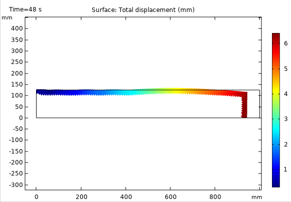

                                                    I found a way by defining a prescribed displacement with the diagonal H-vector being set at 0;0 for the upper and 0;1*(y>y_wall) for the lower row. this way, the only constraint is in positive y-direction when y>y_wall is true.
it works for parts of the boundary with limited mechanical stress (left in picture), but seems to have problems when stresses get higher. (right in picture) Is it possible that the deflections due to mechanical stress are greater than what the solver can correct? I tried to reduce the maximum step contraint, but it has not changed anything.
