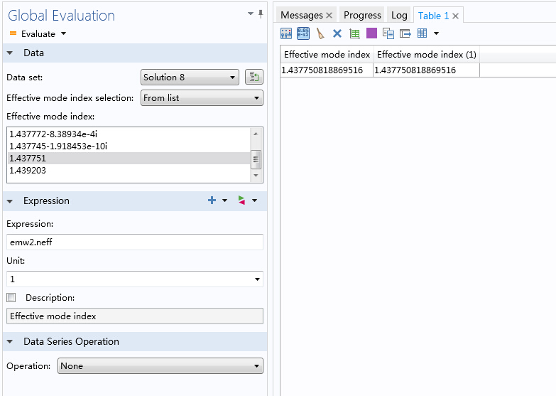

Did you get around the problem of getting zero in the imaginary part of effective index ? Was it by applying a small imaginary refractive index for silica ? what was the value ?
Hi Did you get around the problem of getting zero in the imaginary part of effective index ? Was it by applying a small imaginary refractive index for silica ? what was the value ?
Posted: 10 years ago 2016/01/01 8:29 GMT-5
Hi, did you solve the problem of getting zero in the imaginary part of effective index? I suffer from this problem a lot, it would be nice if you can help. Thanks.
Posted: 10 years ago 2016/01/01 8:36 GMT-5
To get imaginary part of Neff, you need to apply Perfectly matched layer to truncate your structure.
I feel that the default PML in comsol is not accurate. Might be my mistake. You can try anisotropy PML.
alternative, if your material refractive index is with imaginary part for example 1.45+1i, then, without using PML, you will get Imaginary Neff.
If your material refractive index is purely real, then, you will forever won't get Imaginary Neff if you didn't use PML in your mode analysis.
Hope this helps.
To get imaginary part of Neff, you need to apply Perfectly matched layer to truncate your structure. I feel that the default PML in comsol is not accurate. Might be my mistake. You can try anisotropy PML. alternative, if your material refractive index is with imaginary part for example 1.45+1i, then, without using PML, you will get Imaginary Neff. If your material refractive index is purely real, then, you will forever won't get Imaginary Neff if you didn't use PML in your mode analysis. Hope this helps.
Posted: 10 years ago 2016/01/01 8:47 GMT-5
Thanks for your immediate reply. The thing is I have setup the PML layer and get the imaginary part for most of the effective indexes. But the problem is, for the optimal effective index with minimum value of imaginary part, I can not see the exact value of imaginary part. I guess it may be a matter of the value is too small, e.g. <E-12i, so it is not displayed. The attach file is a screenshot of the effective index I got.
In the Comsol3.5 version, we can get the exact value via generate the report, but I don't know how to deal with it in COMSOL4.4. Any experience with this?
Posted: 10 years ago 2016/01/01 8:56 GMT-5
This is because the Imag(Neff) is too small. Loss is negligible.
You can see the full precision at comsol UI. On the bottom right (the table..), you generate your Neff and click the full precision.
Or if you have comsol matlab, you can see the full precision also.
This is because the Imag(Neff) is too small. Loss is negligible. You can see the full precision at comsol UI. On the bottom right (the table..), you generate your Neff and click the full precision. Or if you have comsol matlab, you can see the full precision also.
Posted: 10 years ago 2016/01/01 9:25 GMT-5
I have tried evaluate neff in the table with full precious, but it just display the full precious of the real part, for the imaginary part, it is still not viable. See the attache file for the detail.
Posted: 10 years ago 2016/01/01 21:29 GMT-5
get the imaginary part of neff.
imag(emw.neff)
i prefer to use comsol matlab, where you can extract the data directly.
get the imaginary part of neff. imag(emw.neff) i prefer to use comsol matlab, where you can extract the data directly.
