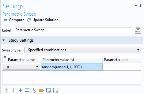

If I understand your question correct, you can just use a parametric sweep like random(range(1,1,1000)).
Se attached screenshot.

Hi, If I understand your question correct, you can just use a parametric sweep like random(range(1,1,1000)). Se attached screenshot.
Posted: 5 years ago 2020/02/28 8:17 GMT-5
Hi, Thanks for your answer. I don't think that works in my case, because I need this set of numbers for a single simulation. If I understand correctly this will generate a random number for each simulation. Maybe more context helps: I want to make step-like variations of a quantity, with different step lengths, and the set of numbers would set the boundaries of this steps in space.
