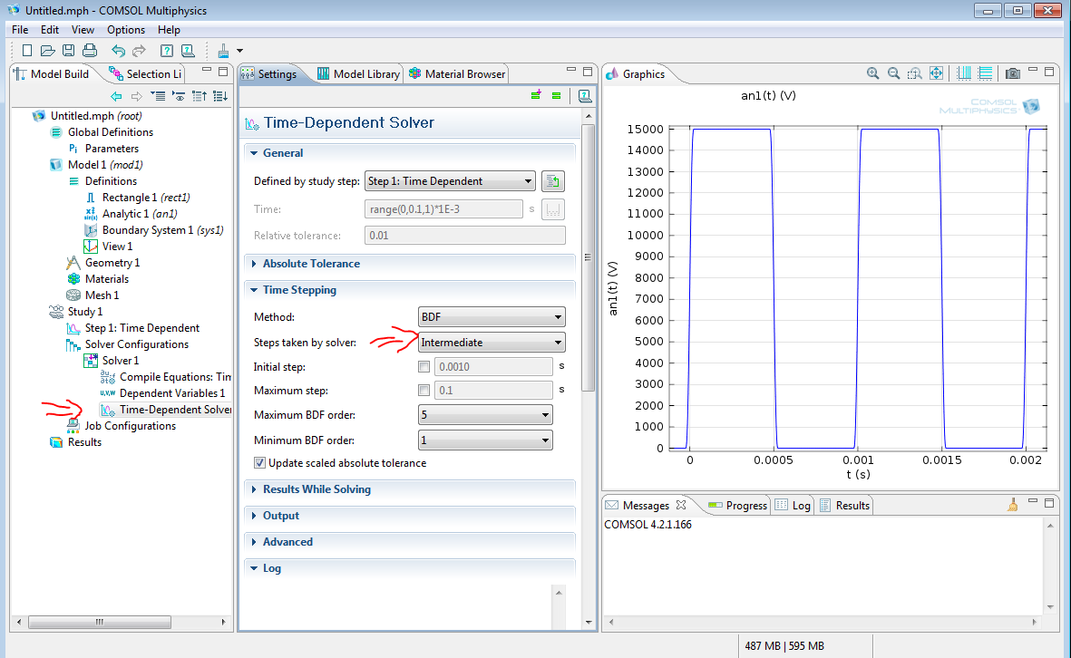

to generate symmetric pulses you can use the "wave square function" for your asymmetrical ones you need to combine a "pulse" to have smooth turn on and off, and a modulo to get it repeat.
And do not forget to use "time Stepping" Intermediate, else your pulses will disappear

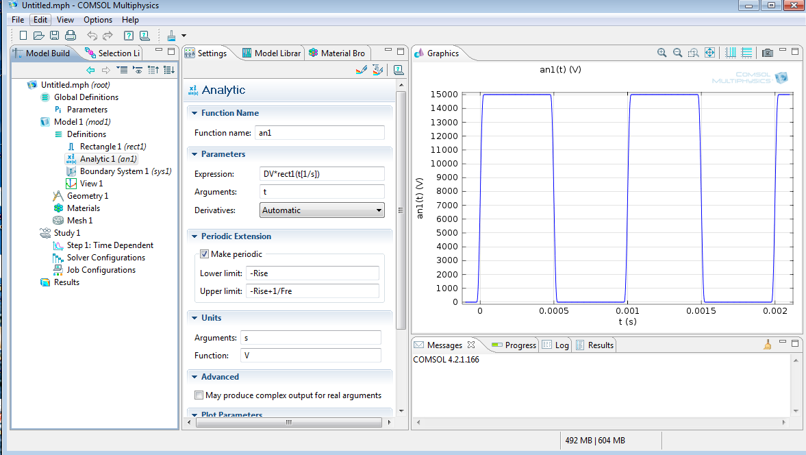

Here are some advises:
if you choose "make periodic", you do not need the "mod(t,1e3)", just "t" as the mod is already there
if you want to look at the plot, put Plot parameter 0 0.004 to see some details, if you ask for 12 million oscillation your screen resolution is not good enough. The plot Parameters is only for the visualisation of the plot of your function, nothing to do with the solver sequence.

Do not forget to define a time stepping for the time siler that sees the short rise and fall times

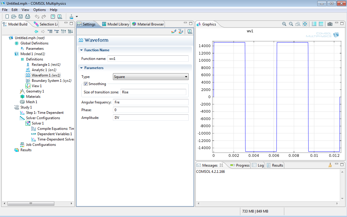

I remain convinced that you should rather analyse 1 pulse, extract the average energy there from and apply that in a stationary analysis rather than trying to resolve 5 hours of 1kHz, 20us rise time rectangular pulses. But up to you to try. Anyhow COMSOL does not allow to have more than a few hundred thousand elements in a list so you must stop and restart manually each "1 hour"
You could try something like this (4.2a):
Hi I remain convinced that you should rather analyse 1 pulse, extract the average energy there from and apply that in a stationary analysis rather than trying to resolve 5 hours of 1kHz, 20us rise time rectangular pulses. But up to you to try. Anyhow COMSOL does not allow to have more than a few hundred thousand elements in a list so you must stop and restart manually each "1 hour" You could try something like this (4.2a): -- Good luck Ivar

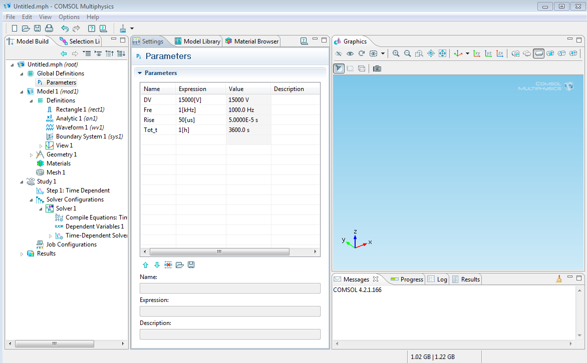

Your DV is not really a "Parameter" as it depends on "t" and an analytical function, and "t" is not really defined before the time solver starts to operate.
Use "Parameters" for static values that you call elsewhere, and rather define your variable in model1 Definitions Variables as DV=an1(t([1/t])*1[V]
the units is there because you have not defined any units in the analytical function definition an1(), there you can define seconds as inputs and Voltage as output and then remove all unit references in the calls, up to you.

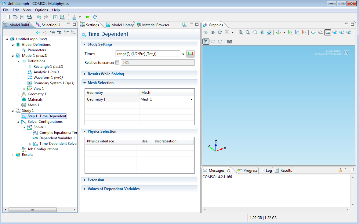

Time stepping: start to resolve 2-4 [ms] first with something like range(0,0.05,2)*1e-3
then increase gently, finally you might get to hours. and used a Time stepper range node "linked" to the solver 1 range

To get your solution to converge:
start using a "study 1 - Time dependent" range of range(0,0.0001,0.01)
And study 1 ... solver1 - Time dependent solver" tab, set the "Defined by study step" to Step 1 (and NOT User defined, else you must change the range 2x, this was a weakness in 4.0, no longer in the newer versions)

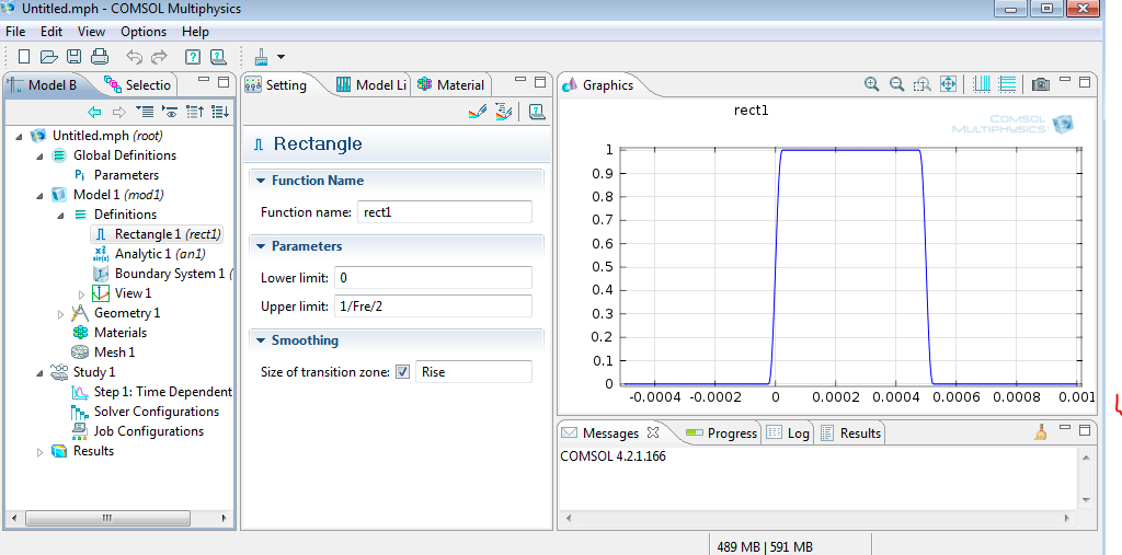

first in your meshing, delete the Free Triangular 1 (and leave the 2), (note: test later the mesh sensitivity, by setting the size to extremely fine, and then custom Resolution of narrow region = 3)
Then in your Global Definition rectangle type your Parameters to Lower Limit 0 + 0.1E-4/2 and Upper limit 0.5e-3+0.1e-4/2 and leave the smoothing to 0.1E-4
Like this your an1(t=0) starts at V=0 and not half way up 8000V, which is too much for the solver
Then it works better

1) when i make my pulse train , an error occured and seis no set of argumenr despite of putting the rang of t !!!!
2) the second problem , is when i changed the variable to wv1 (sinewave) and try to solve the model (just to see its behavior) it gives me error and i don't know why?
please, i attched my model , take a look and give me your advise
Thanks Ivar! Really helpful.
