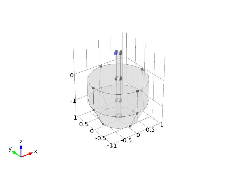

I am dealing with a rocking pile embedded in a soil which I am loading with a time-dependent force. (F = 5000*sin(omega*t)). I use identity pair as pile/soil interface with a continuity condition. I have enabled weak constraint.

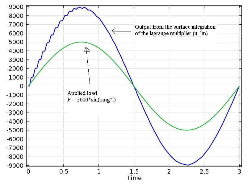

Problem is, when I integrate the lagrange multiplier (u_lm) for the surface area (the pile/soil interaction surfaces) I get a output (a force) which is approximately 1.9 times larger than the force I load with. What I do is the following, >derived values > integrate > surface integration), chose my surfaces and evaluates u_lm. I have also tried to add all three multipliers (u_lm+v_lm+w_lm) without success.
I have attached a figure showing the dicrepsencies between my input force and the force calculated by integrating u_lm (langrange multiplier)

indeed a 1.9 factor is almost 2 which could indicate that your are doubling the items integrated over.
The LM integration is normally done as a "sum". COMSOL is programmed to detect this and arrange the integration accordingly, but sometimes you must help manually, there is a settings in the operator definition to force integration or node summation (the latter should apply to pure LM's)
Hi indeed a 1.9 factor is almost 2 which could indicate that your are doubling the items integrated over. The LM integration is normally done as a "sum". COMSOL is programmed to detect this and arrange the integration accordingly, but sometimes you must help manually, there is a settings in the operator definition to force integration or node summation (the latter should apply to pure LM's) -- Good luck Ivar

I have here a more simplified version of my model (Unsolved). I found the node controlling the method on how to integrate. It does not change the picture. Mayby with my model at hand, you will be able to see what I am doing wrong.

there are a few things, minor we have different habit ;) whcih makes the model more difficult to understand
I'm not sure you variable "Es" is correct, you are probably missing a factor 10. It's easier to use the material tabs for the material data.
Do not mix parameters and variables, put all your constant "Variables" in the Parameter list and keep the variables for items calculated from solver model results (as far as possible)
Avoid using point loads, user rather boundary loads, this makes less singularities and cleaner results (solver might fail too)
With such a nice 2D-axi model, you are quicker running (and debugging) in 2D-axi, but OK perhaps later you want to make it less symmetric
Try to avoid fixed points too, there too use boundaries, and I do not understand why you select point 33?
I would have started with lower boundary 7 fixed
More important: in "assembly mode" that strictly in this case you do not need, except if you want to later set up contact and friction ? You should select "Create Pairs" this will automatically create the required pairs for you, and if you select "create imprints" you will get a cleaner mesh assembly across the pairs
For periodic time sequence, use a time stepping of "intermediate and not the default "free" type, it skips too many solver steps
and to start with use only 10 points across a sinus period, to debug, you wait far less ,and you gain nothing. when your model is clean, then you can run once over night with a higher resolution
