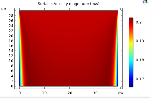

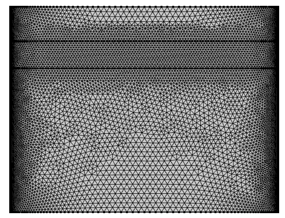

I'm doing a 2D model of a transient incompressible air flow. I have 3 rectangular regions. Actually the central rectangle is intended to represent a porous medium, but I will activate this option when I'll be sure I'm obtaining the right profiles.
So, I put normal inflow velocity as inlet boundary condition and atmospheric pressure asoutlet boundary condition. Other boundaries are defined as walls. Initial pressure was defined as atmospheric pressure and initial velocity as zero.

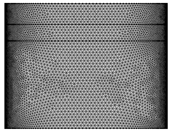

I've tried several meshes (two of them are shown below). Element quality of all elements in higher than 0.4. I've done studies using differents final times(from 0 to 100 s) , either using user controlled tolerance (0.001; 0.005, etc) and physics controlled tolerance.
My magnitude velocity profile at any constant y for my final time (20 s for example) should be parabolic, because, I mean, it is just a gas flow through a pipe, so normally there is no mistery on it, but I found always the same profile as shown in the picture. This profile shows a higher velocity in some regions near to the wall than in the middle of the rectangle which is obviouslly ilogical.
I'm stuck since several days ago on this problem.
Do you guys have an idea why my profile is always like this??? Any suggestion is welcome.
Thanks in advance, Jhoan.

Actually I've tried also using a fully developed flow as inlet boundary condition in which I had to define an average velocity. This way I obtained a symmetric parabolic profile :) after a time of 15 seconds, but then when I actived porous medium option, I obtained a profile even worse than the one shown in the last message (you can see the new profile below). BTW when I use high final time ( 100 seconds or bigger), simulation doesn't converge (Maximum number of Newton interations reached).
Any suggestion of how to solve those problem is sincerely apreciated.
Thanks, Jhoan

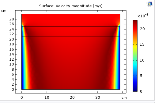

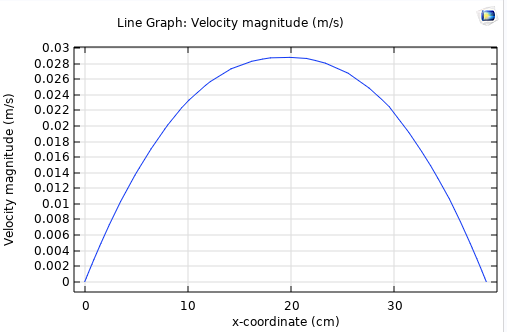

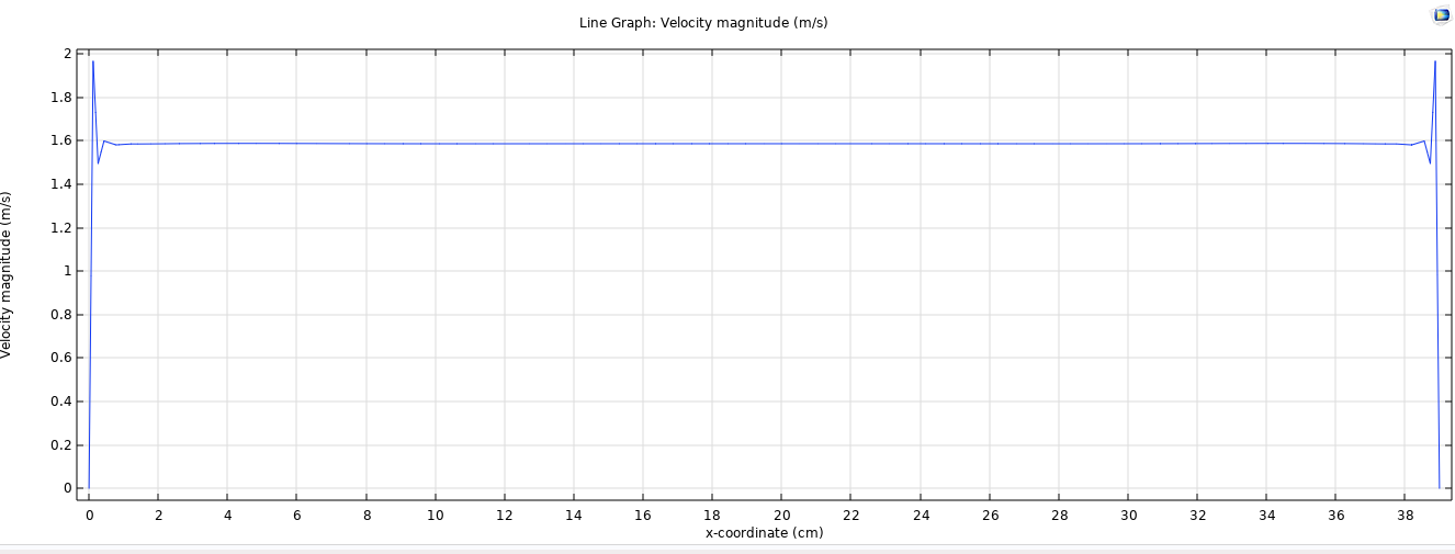

So, in order to understand my problem better, I decided to plot velocity profiles, for the same geometry and mesh, so I could obtain whether laminar or turbulent flow just by changing inlet velocity (and COMSOL physics). I understand that a minimum tube length is needed to obtain a fully developed flow.

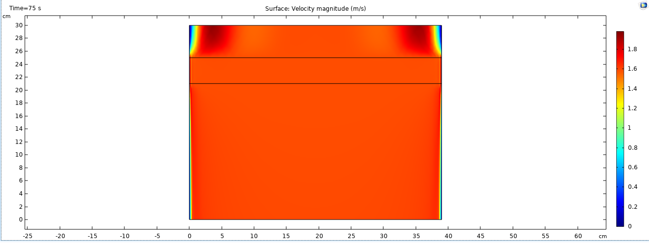

On laminar flow simulation for a long length I obtain a good profile (as shown in the picture 1), but there is a problem at wall section near to the inlet. 2D visualization shows a region where velocity seems to be bigger than in the centre of the figure for no reason (FIGURE 2).
I've read this could happen because I didn't have an extended domain just for inlet boundary condition (as suggested in this blog ),so, then, I stablished symmetry conditions in a part of the wall near to inlet boundary to get over this problem. Even by doing this, I keep having samekind of 2D visualization (FIGURE 3). Maybe anyone has an idea on why is it happening?

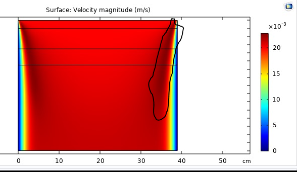

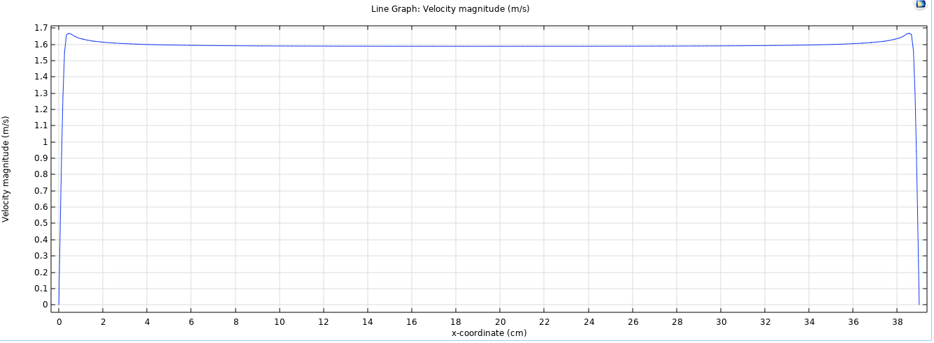

On turbulent flow simulation, Reynolds number is 6300, I'm using k-epsilon turbulence model since it's most well-known model. Main issue is velocity magnitude at wall is not zero (about 0.17 m/s as shown ih the FIGURE 4), even when changing Re, mesh or whatsoever :(.
I've also tried with other turbulence models as SST and Low Reynolds k-epsilon but I keep having a non-zero velocity at wall ( about 0.003 m/s). Since k-epsilon is the most studied and well-known model, normally I should have the best results, isn't it? Any insights about this?
Thanks in advance and stay home as much as possible guys, Jhoan
