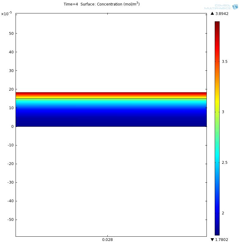

The problem I have is that the concentration in the chamber increases near the boundary where I set the Moving Wall.
There is no physic explanation of that, and I don't know how to solve. I tried changing the Coordinate System, but I don't know if the problem is there, and it didn't work.
In the attachment there is an image of my result.

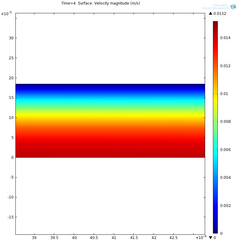

The velocity seems to be correct, it's 0 m/s near the moving wall, as you can see in the attachment (I forgot to say that there is a symmetry on the bottom boundary, but I have the same problem without the symmetry condition).

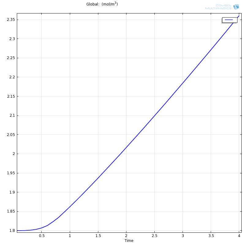

In the second attachment there is a graph of the average concentration in the chamber. I'm expecting the average concentration to be constant in time, but it's increasing, and I don't know why.

I double checked the Velocity (spf.U, u, v, etc) in Results and it seems to be correct.

Today I tried to reduce the chamber size, instead of expand it, and I found that there is the same problem, but the concentration near the moving wall in this case decreases!
