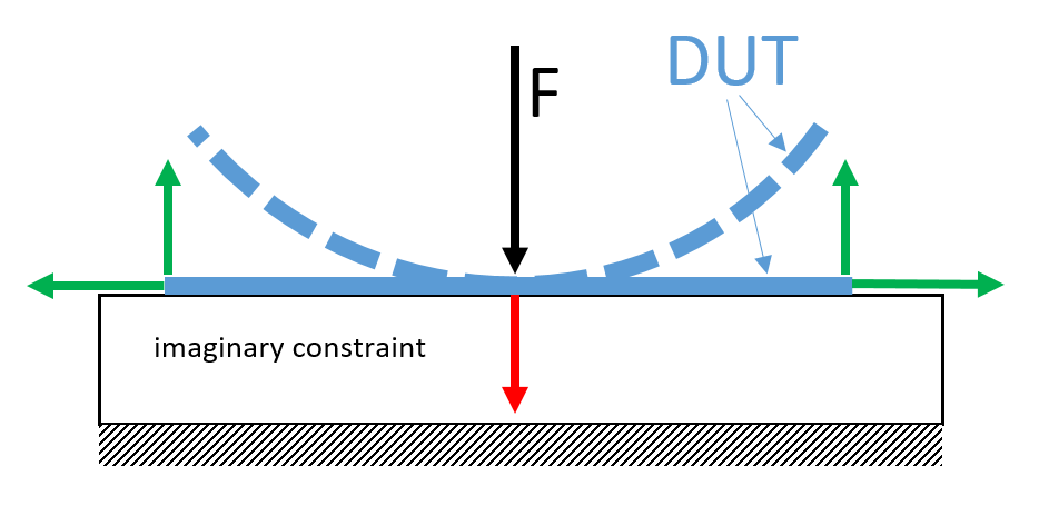

Rigid Wall / Basement Mechanical Constraint
it´s probably a ridiculous question, but I need a mechanical constraint just like an ideal rigid wall or basement which the DUT is unable to penetrate but is able to lift off it. A roller constraint where a displacement in z is possible and -z=0 would be perfect. Imagine a flat metal sheet which experiences a force just in the middle and is able to deform like a bowl. I know such a constraint from other CAD (FEM) programs like SolidWorks as "rigid wall" but did'nt found a handy solution in COMSOL. I hope it´s possible without writing own eq´s. Currently I a built a 3d model.
Thanks for your help,
BR Sven

Sven,
sounds like this might be a contact pair.
Cheers Edgar

Hi Edgar,
thanks for the reply. Maybe, but wouldn´t it necessary to have a second geometry to create a contact pair? This geometry would have to be meshed as wel, right? I wanna avoid an additional geometry and thought there is a simple solution as described like a roller constraint with a free +z direction. If not than something like that should be implemented in COMSOL because one need it very often.
Thanks,
BR Sven

Hi Sven,
Adding that extra geometry and meshing it is a quick operation.
  1. Add a Workplane (maybe reorient it, but Z-normal is the default)
  2. Add a Square in that workplane, and set its size to be large enough
  3. Under Mesh, add a Mapped node, and select the newly generated square.
Now you can use the square as the Source in a contact pair.

Hi Henrik,
that sounds as if it could work=). Thank you very much, I will try it like that.
BR Sven

Hi Henrik,
I tried your suggestions. The plane and the square are fine and the meshing too. Do I have to create the plane in a certain distance to the object or directly on the objects lower surface? Additionaly, if I wanna apply a fixed constraint to the square it´s not selectable (the square). Is this necessary at all? Or is this already implemented? If the study doesn´t converge, what are the typical problems?
Thanks so far,
BR Sven
